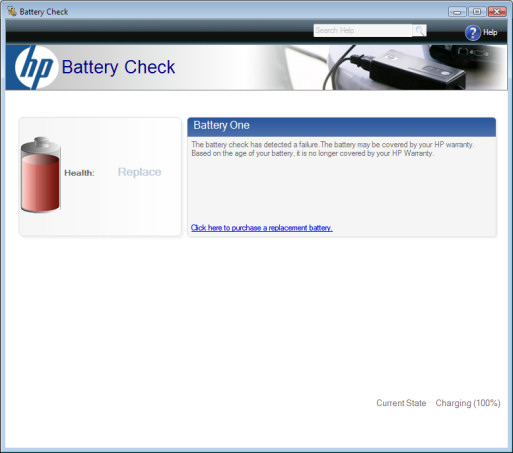

Oh hai, mister factory-installed HP battery check utility:

#319574 - 20/02/2009 01:08 Re: Reprogramming a laptop battery? [Re: tfabris]
The battery check has detected a failure. The battery may be covered by your HP warranty.
Based on the age of your battery, it is no longer covered by your HP warranty.
In other words, PSYCH!
