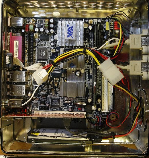

This is the EPIA mobo with PicoPSU (yellow and red bits) that runs our rtr.ca cookie-tin server here.
Description: rtr.ca in a cookie-tin: PicoPSU near top right.

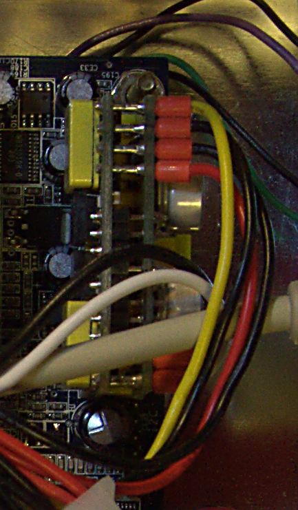

And a close-up crop of just the PicoPSU part.
Description: The PicoPSU, in-situ.
#321414 - 14/04/2009 18:41 Re: The Hackintosh [Re: mlord]

Is the electrolytic cap just below that Pico PSU board swollen? Perhaps it's just a trick of the light but it looks bad in both photos.
#321417 - 14/04/2009 20:50 Re: The Hackintosh [Re: AndrewT]
Posts: 14503
The two photos are actually just a single photo.
But thanks for pointing out the cap.. I'll try and have a looksee later on.

#321421 - 15/04/2009 00:12 Re: The Hackintosh [Re: mlord]
Posts: 14503
Okay, I had a look into the cookie-tin just now.
Yup, that particular capacitor is bulging quite a bit on top, as are about four similar ones of the same brand elsewhere in there.
I wonder how much longer I can ignore them? smile
