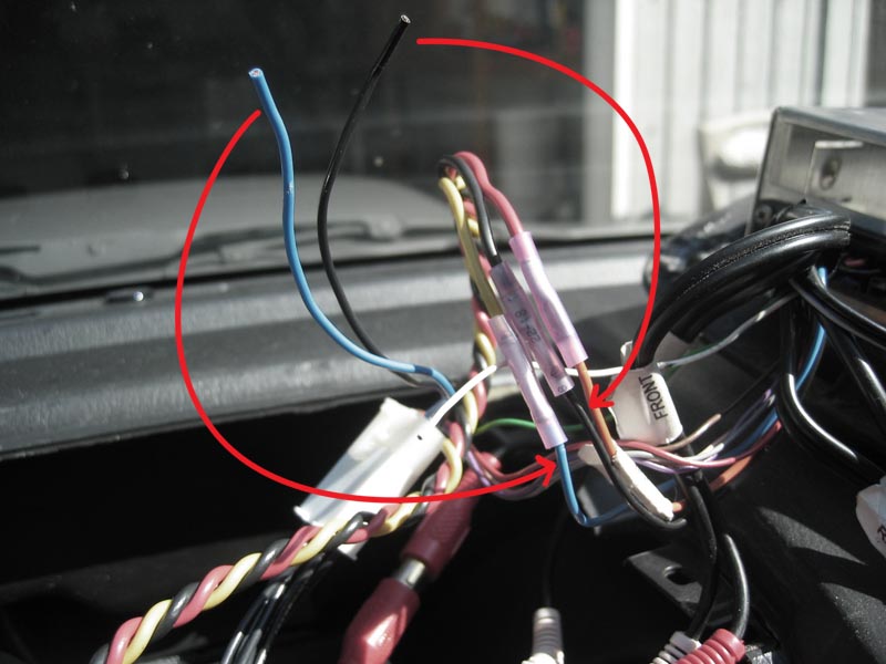

Hi guys... I was hoping someone here could give me confirmation on getting my tuner to work in car with my empeg.
I had my Mk2 installed in my 2006 WRX a few years back. It's worked more or less fine, other than my issue documented here Dim or Turn Off Standby LED?.
From the looks of it, the Blue Amp remote wire is plugged into power. I am not an electrician (and now possibly my installer wasn't either), but it appears they have made minced meat of my sled wiring. The Blue Amp Remote wire and Black Ground have been cut from the tuner plug and wired directly into the vehicle.
I'd like to use my tuner to interface with a Sony Stalk Remote. Can I just splice the blue and black wires back onto the tuner plug and have this work?
Second question... looking at this mess, can anyone see what else is wrong and maybe point me to a solution?
Thanks very much... image to follow

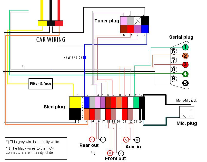

If those cut wires were originally from the Tuner Plug, then yes you need to hook them up there to make things work. Check out the Tuner Plug wiring diagram here:
Diagram:
Key:
The blue wire on the right, if that is coming from your Empeg Sled then yes, thats not connected up right. That wire is supposed to be 'Amp Remote' which goes +12V when the Empeg powers up so your amplifier knows to turn on.
The yellow wire from the car harness is probably 'Memory' which is the permanent +12V that the Empeg should be powered by. If you have a VW or derivative Memory and Ignition Sense may be swapped over.
Note: There are probably two Blue wires from your Tuner. One is supposed to be on the Tuner Plug. The other is hanging free - this one is the Antenna Remote wire which goes +12V when the source is switched to 'Tuner' on the Empeg. Use this for signal boosters and those retractable electric aerials if you need to, else tape it up and tuck it away. Don't mix them up.

Thank you so much for the reply... I have two questions about how to proceed.
Just to confirm, the blue and black wires at the top of the first image are indeed from the Tuner Plug. I used a print out of the image you included below from the FAQ to confirm my suspicions. Thanks for including it for completion sake.
Question #1:
Short term. The empeg works with the current wiring. If I were to splice the blue Amp Remote and the black Ground from the Tuner Plug back into the matching wires from the sled, the Tuner should work?
Question #2:
Going over the diagram I seem to remember the yellow Memory wire had a black plastic piece that I assume was the "Filter and Fuse" shown in the diagram. That is sadly long gone. mad If I could find a new wiring harness for the empeg, would this revised diagram I am attaching be the correct way to hook everything up?
I'd love to take this information back to the original installer, but they are no longer in the Car Audio business.

The diagram you have drawn looks okay to me.
I'm curious, where is your yellow cable from the sled connected to?

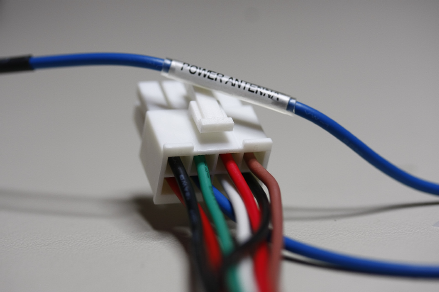

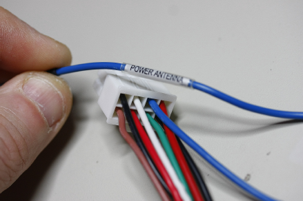

Here's where the blue wire (for power antenna) connects to the tuner end of things.
Description: Tuner end of the extension cable.
Description: Flip side of tuner end of extension cable.

Fantastic! Thanks! Yes, based on the wiring diagram, that looks like it backs up my theory. Simply add a pin and a blue wire to the one unused hole on the standard tuner connector. Test its behavior with a voltmeter.
The hard part might be finding a pin for that connector, at that point, just call Eutronix anyway and get a proper extension cable. smile
