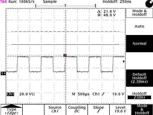

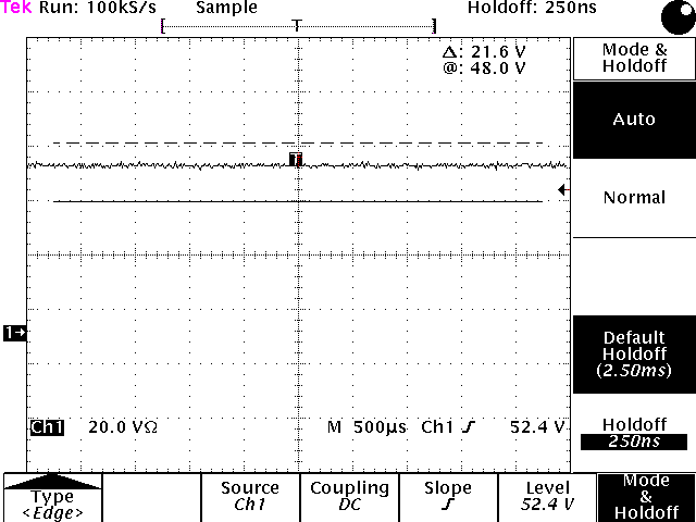

I wonder if a Tek TDS2000 really is this noisy. Anyone got one? Connect a AA battery to it, and check the noise level at 500mV/div. We have a number of Tek oscopes at work. I don't know what models they are, but I bet they're quite high end. (We design chips that run at very high frequencies.) Regardless, I'll try that out on Monday with one (or more) of the scopes and let you know. Remind me, though. I'm almost certain to forget.

If I have time, I will get some waveforms for you too. I have an HP 250 MHz 1GS/s Digital, aa HP 400 MHz 1GS/s Digital, 350 MHz Tek 485, HP 1GHz Digital, and if I have time I might get our my Tek 7104 1GHz Analog.

I'm mainly interested in results from scopes that cost less than $2000 or so, but a higher quality one or two would be fun as well.
Really, it's been so long since I had a scope, that all I can remember are smooth lines on them. And this scope never has smooth lines, so I don't know whether this is a problem or not.

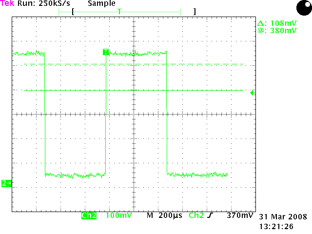

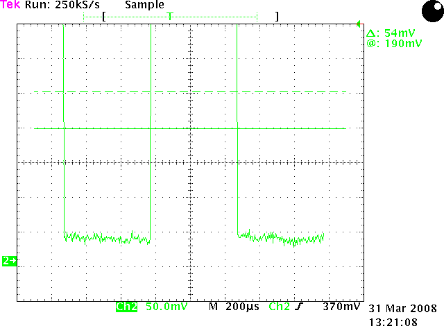

How many volts/div was the display set for ?

How many volts/div was the display set for ? Whoops. Forgot about that part. Here are some more images, both with the 1kHz test signal.
Description: 50mV/divDescription: 100mV/div

Okay, so they're not that much different at similar settings.

Also keep in mind that the one I tested on is like a $30k oscilloscope.
