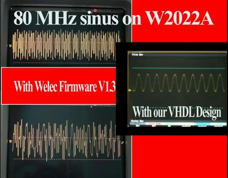

#324635 - 26/07/2009 15:52
Re: Welec W2022A Review page
Posts: 14494
Wow.. there are just so many firmware bugs, that I've now created a web page just to help track them. And since there is no other third-party info available on these products, it may as well be a review page. My Welec W2022A Review is now up. A lot has happened with these scopes of late. Last summer, the (horrible) source code for the firmware was released, and over this past winter/spring some German chaps have been fussing away at it. The current "beta" release of fixes/enhancements, based on the original factory firmware, is actually rather good. I've installed it on my own scope here, and most of the old bugs vanished, while some new features (re)appeared. The FFT functionality has returned with a vengence, though it's still not useful beyond really low frequencies, and the scope is definitely a lot better behaved now. The best thing with the new firmware though, is they've figured out how to reduce the inherent noise in the measurements, to perhaps half of what it used to be. This is good. Related to that last point -- another person has been poking at the FPGA code, and determined that *all* of the visible noise is just the result of some firmware bugs. He's recoded some of the VHDL and posted youtube videos (search for welec) showing the difference. Quite astounding results, though it could be a long time before changes like that make it back in the new firmware releases.

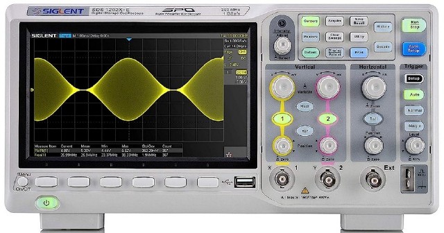

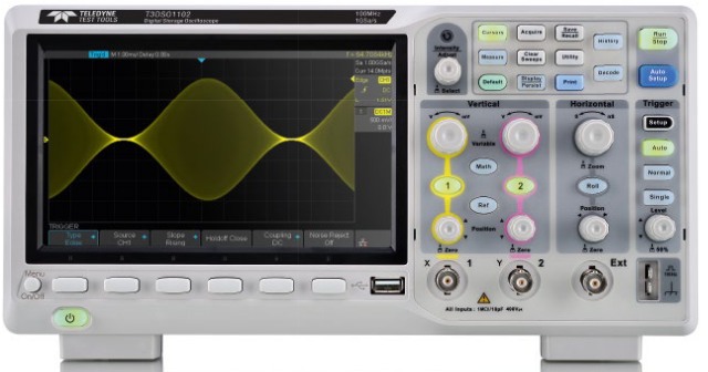

#374332 - 15/04/2024 18:04
Re: Cheap(!) Digital Storage Oscilloscope (DSO), Colour, 200MHz
Posts: 14494
Well, many years later, and the Welec W2022A now has very usable third-party firmware, and a lot less noise on the signals. But I've decided to upgrade to a newer/better scope. There are now quite a few usable digital scopes with good bandwidth out there.
After a lot of reading/research, the perfectionists say to get something like a Lecroy scope, but those are horrifically expensive. In the budget category though, the Siglent brand is highly recommended. So I've ordered a 200Mhz 2-channel Siglent scope (1 gs/sec), for CAD$458+tax. The Lecroy 100MHz equivalent is more than 2X that price.
Real world reviews and measurements indicate the Siglent is the Real Deal, with actual 3dB bandwidth around 240MHz. The firmware for it has had regular updates and is working well.
Notice anything funny about the photos.. ?
Description: Teledyne Lecroy T3DSO1102Description: Siglent SDS1202X-E
#374333 - 15/04/2024 18:07
Posts: 14494
The old Welec scope was imitating a more reputable Aligent's front panel, with totally different innards.
But in this case, Siglent actually designed the scope for Lecroy, but also sell it themselves! The two companies have quite a bit of their product lines "shared" like that.
#374334 - 16/04/2024 15:19
Posts: 31600
Notice anything funny about the photos.. ? It's displaying a waveform but there's nothing plugged into the probe connectors?
#374335 - 16/04/2024 23:40
Posts: 14494
Two scopes, identical other than the Manufacturer's name at top left, and the considerably different price tags. Scope arrived here today, and lives up to the reviews. Including the one on YouTube demonstrating a bug with the built-in UART decoder. A simple firmware downgrade took care of that bug, with no downsides I can see from the ChangeLog. Cheers
