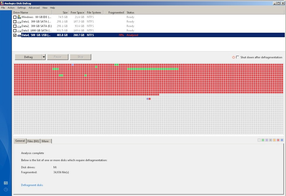

What is this sh*t? I thought I'd do a super-defrag on one of my backup drives, so I formatted the drive and then ran my backup program to produce a nicely compacted drive with no fragments. The backup program copied the files one at a time, in alphabetical order by directory, subdirectory, and file, took most of the night to do it.
The result was a nicely compacted disk with 70% fragmentation! (see the attached photo.)
How is this even possible? Did my backup program choose sectors pseudo-randomly based on astrological signs or something?
WTF.
(To see the attachment in readable form, right-click the file and choose "View Image")

As promised, I re-ran the procedure. The results this time are stranger than before.
It looks as though the about same amount (number of bytes) of the hard drive is fragmented, but this time "only" 40% of the files are fragmented. Whoopee, only 17,000 fragmented files instead of 34,000.

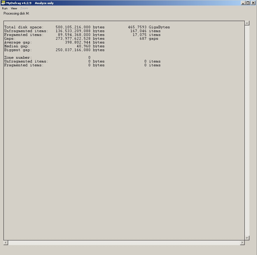

Originally Posted By: taym
I would still suggest you at least give it a try with another defrag program and have it analyze (not defrag) the disk after the backup.
OK. Same results.
OK. Same results.
Ok, I am lost, then. It must be USB or the backup software itself.

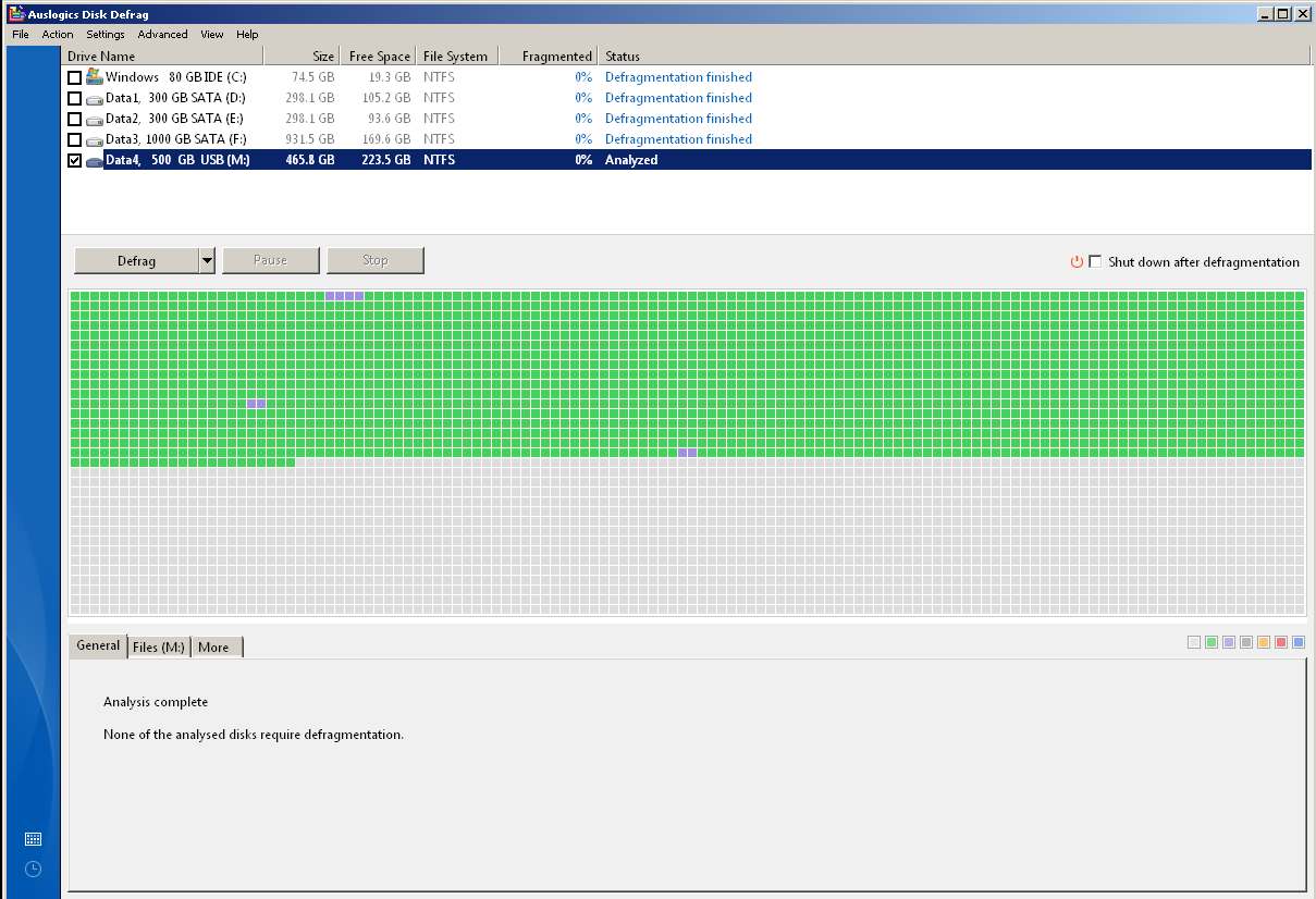

I formatted (again!) the offending 500GB USB external drive, and this time instead of using my backup software I used the Microsoft SyncToy software. It also copies the files one at a time, takes even longer to run than my backup software because it does a lot of file prep before it starts copying.
Results below...
