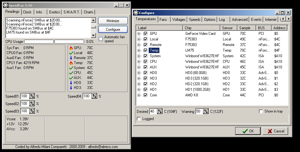

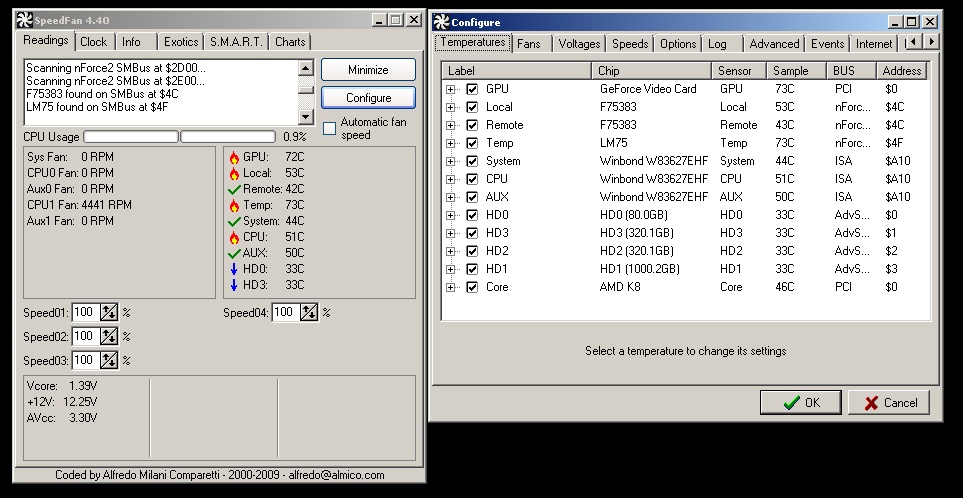

Here are two screen shots from SpeedFan. The first was taken with just "regular" video usage, the second was taken after about 10-15 minutes of full-screen motion-picture video. (Right-click the image and choose "View Image" to see them large enough to be readable on your screen.)
The GPU temperature in both pictures seems pretty high to me at 70--73 degrees C (about 160 F), especially considering that it is 50% higher than any other temperature measured. Or, maybe this is normal for GPUs, I don't know.

70C on the GPU when it isn't being taxed is high.
SpeedFan is detecting the GPU twice for some reason. It is seeing it as a nVidia GPU and as a LM75 sensor chip. The LM75 is unlikely to actually exist since the rest of your system is using a Winbond sensor chip and the values for the GPU and LM75 are the same.

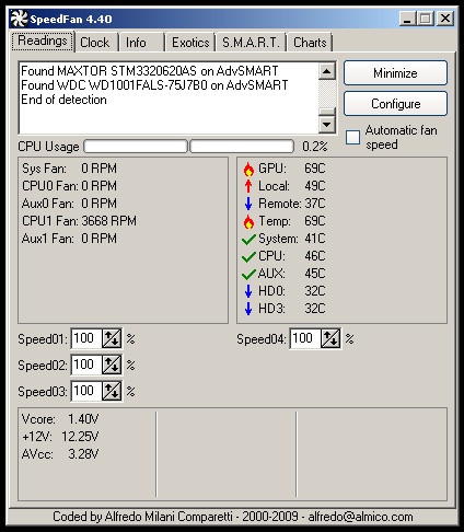

That 70 degree figure is suspect. The attached screenshot was taken less than three minutes after the computer was started up after being turned off for 15 hours. Would that GPU really heat up that fast?

Maybe. If the GPU doesn't have any cooling at all then it can reach high temperatures quickly.
Can you see if the GPU fan is spinning? If so, is the GPU heatsink clean?
