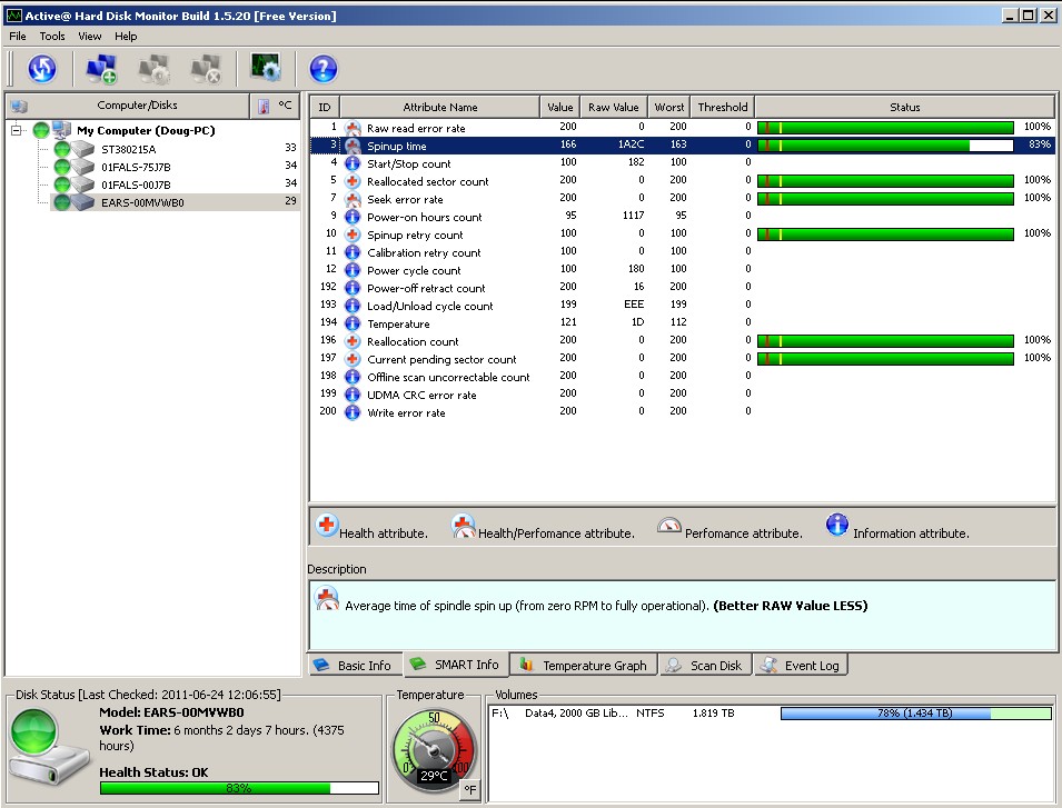

The SMART data for that drive show no obvious problems, so I think the drive may be OK physically. I am concerned about corruption in the file management table (or whatever it is called) on the drive.

If the drive were the cause of the missing data, I think you'd probably notice the operating system also complaining about it at some point.
Since it didn't (did it?), then the operating system itself might be the primary suspect.
