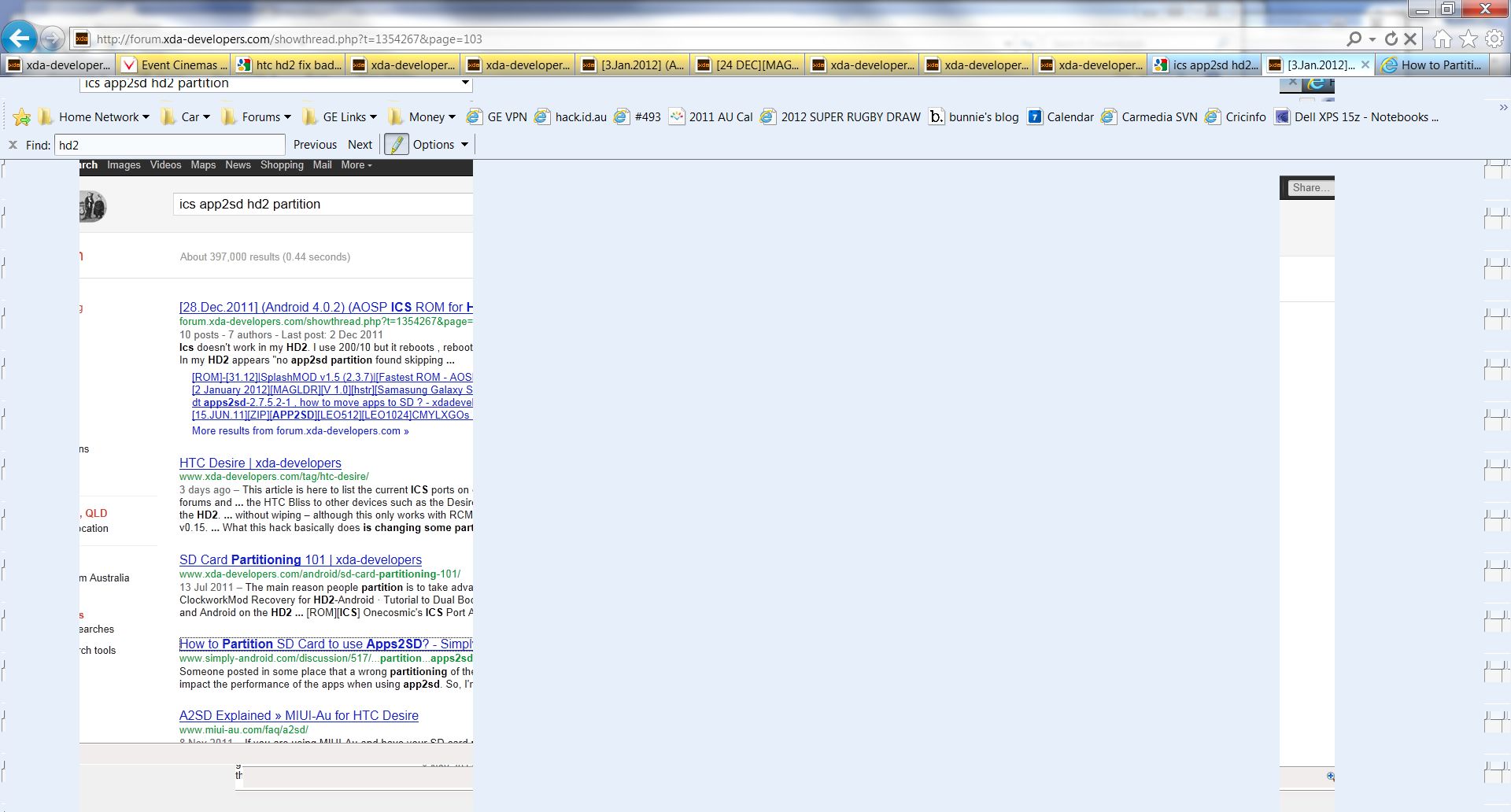

Attached is a fairly extreme version of the corruption. I have latest Intel video drivers installed

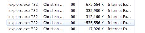

I do note that it seems to happen worst when IE9 has stacks of memory allocated. It seems to have fairly significant memory leaks. With those tabs open, Task Manager is showing approximately 2GB of memory across 4 iexplore.exe processes
The board seems to limit image sizes regardless of what I do but a direct link is here:
http://empegbbs.com/ubbthreads.php/ubb/download/Number/6431/filename/Corrupted%20Video.jpg
