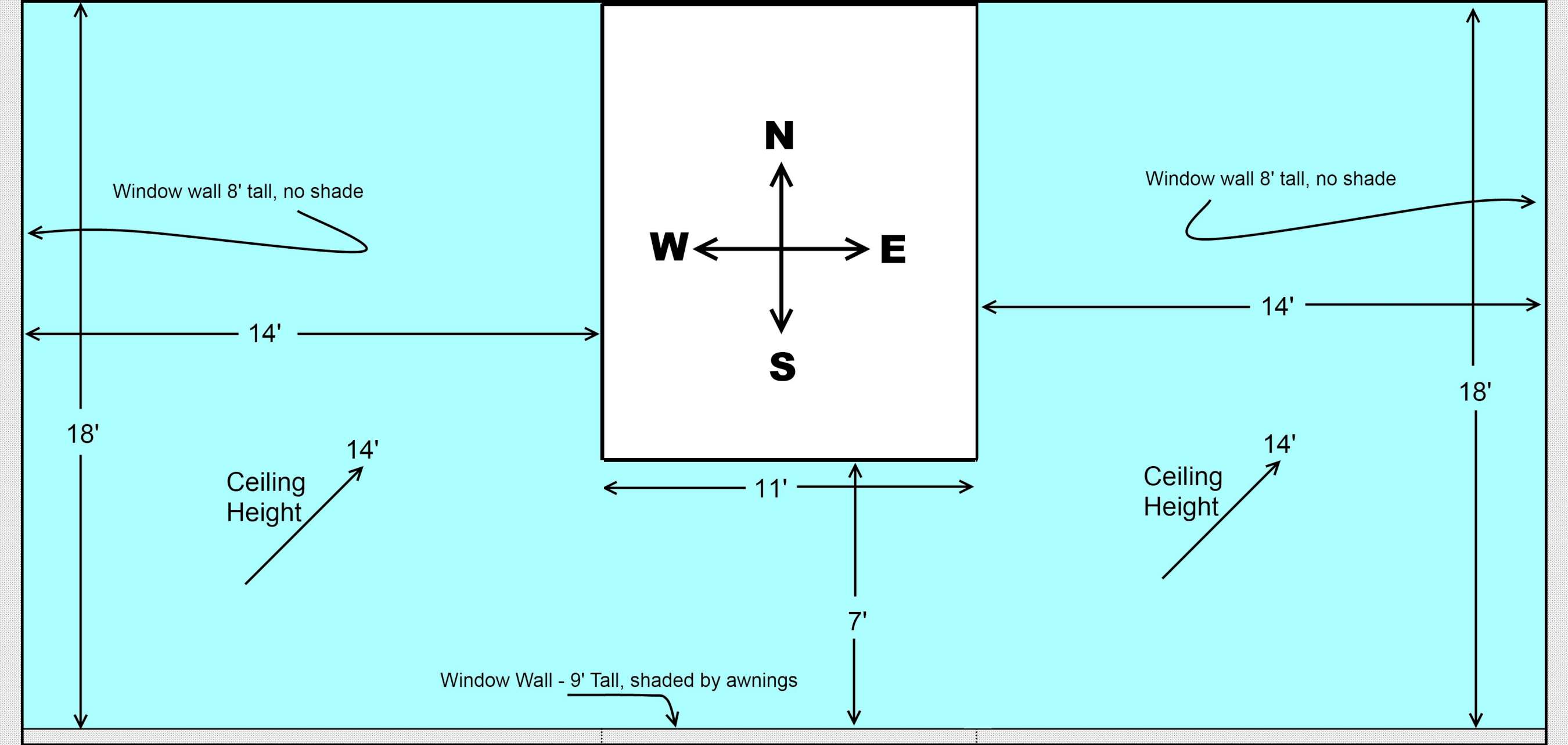

I am distrustful of the results, because the annual operating expenses seem unreasonably low. Attached is a rough layout of the area that I am trying to air condition. The calculator linked above said I would need 26,300 BTU/hour. Does this seem reasonable? There is only about six weeks a year that the A/C would operate, daytime temperatures seldom exceed 90 degrees (F), evening temperatures usually drop down into the high 60's. We would be cooling the house to about 75-80 degrees. All walls (interior and exterior) are 8" masonry, as is the ceiling, all uninsulated.
I know some of you have a lot of experience with air conditioned homes. Does 26K BTU seem right? How many hours a day do you think it might need to operate?

Is there anything you can do in terms of external shading or insulation to moderate the cooling requirement? Seems a shame to install a huge AC system for 6 weeks a year
#351404 - 08/04/2012 06:32 Re: Proper sizing of an air conditioner [Re: tahir]
Posts: 1938

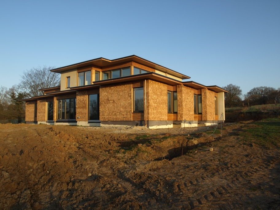

Looking at the plan a bit of a roof overhang on the W & E would make a huge difference to the amount of morning and evening sun, S would deal with the rest of the day. A bit of external insulation on the roof would help too.

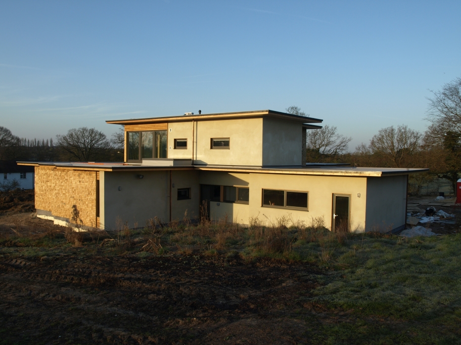

Even here in the UK our architect was worried about summer overheating (lot of glazing) so we have around 1 mtr overhang all the way around the house.

As a matter of act, there is about a 1-meter wide soffit above both the East and the West windows, but by the time the sun has climbed high enough that the soffits would offer shade, it has swung around enough that the awnings on the South windows have taken over the job of sun blockage.

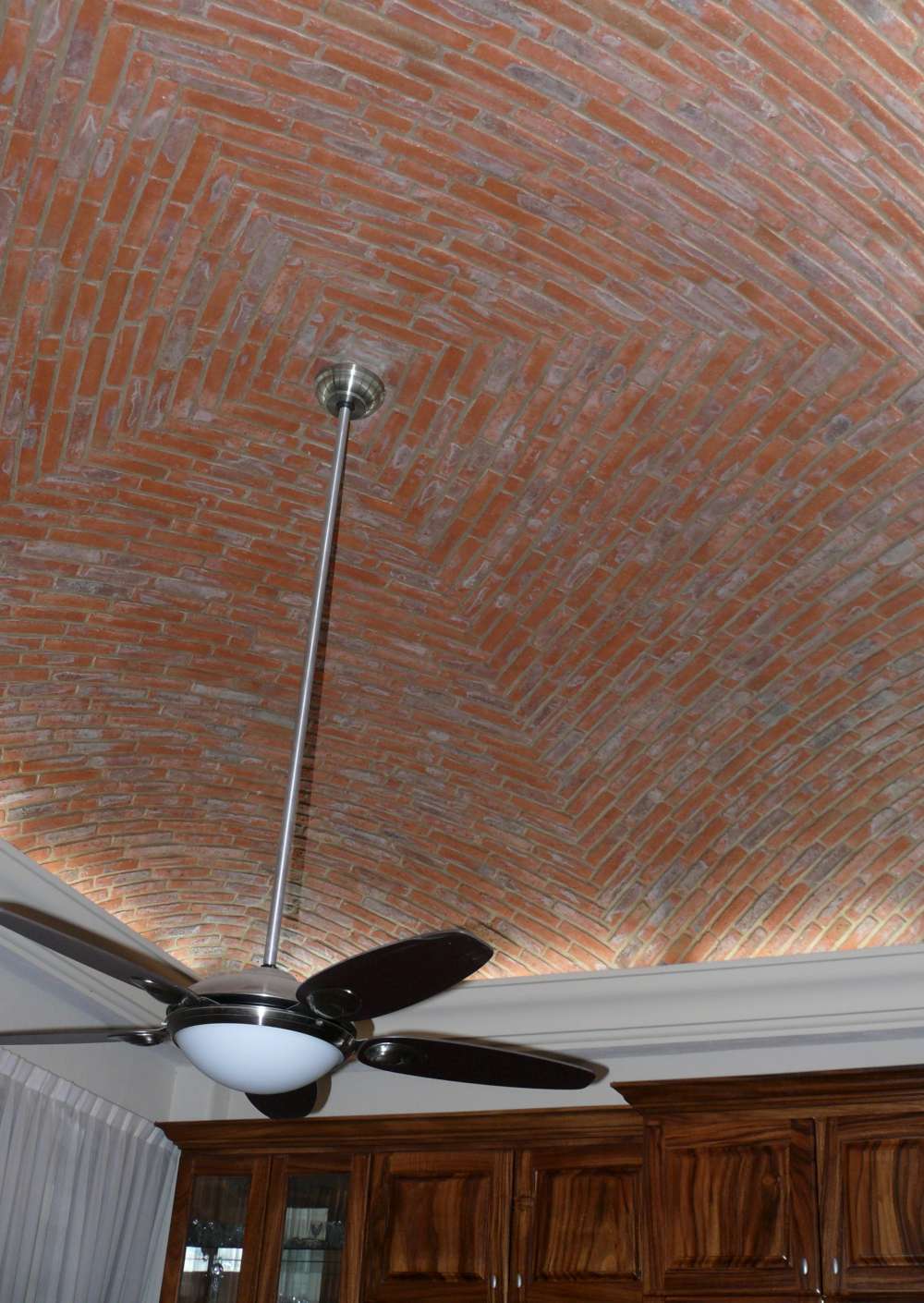

Insulating the roof is not easy. The ceilings are domed, and thus the roof (outside) is domed as well. It isn't just a matter of laying down sheets of styrofoam insulation, it has to be cut and shaped to fit the contours of the roof. I got an estimate, don't remember exactly how much it was, but the A/C was cheaper.

My office is 1/2 of that size, but similar in that it's mostly glass. You're lucky 'cos in the summer months the sun will be north of you and away from that big south glass wall.
I had a 12K btu air con in my office and it wasn't nearly enough. I had to start it early in the morning to give it a chance to keep the office just mildly hot in the afternoon. This is with outside temps in the 90s.
So, you've got double the air con, and double the space and windows. Even with the solid north wall, you might consider the next larger size air con. And at least two of those heads.

It is indeed very cool. We looked at a timbrel vaulted roof for our new house, the engineer we spoke to had already completed this one and went on to do this one
One of the reasons the architect was keen on the vaulted ceiling was how much weight it would carry, ours was designed to carry 6ft of soil above.
We've ended up with a much more traditional (but still super insulated) construction, the roof will be planted over autumn.
