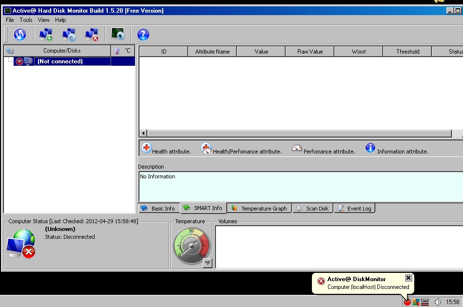

I thought I would start up the Active@ Hard Disk Monitor program and look at the operating information for the hard drive(s), not that I would have understood much of it, but instead got a "Not Connected" error. (See screen shot.) Hunh? Could it be that I can't start that program after the computer is booted up, but must have it in my Startup menu instead?

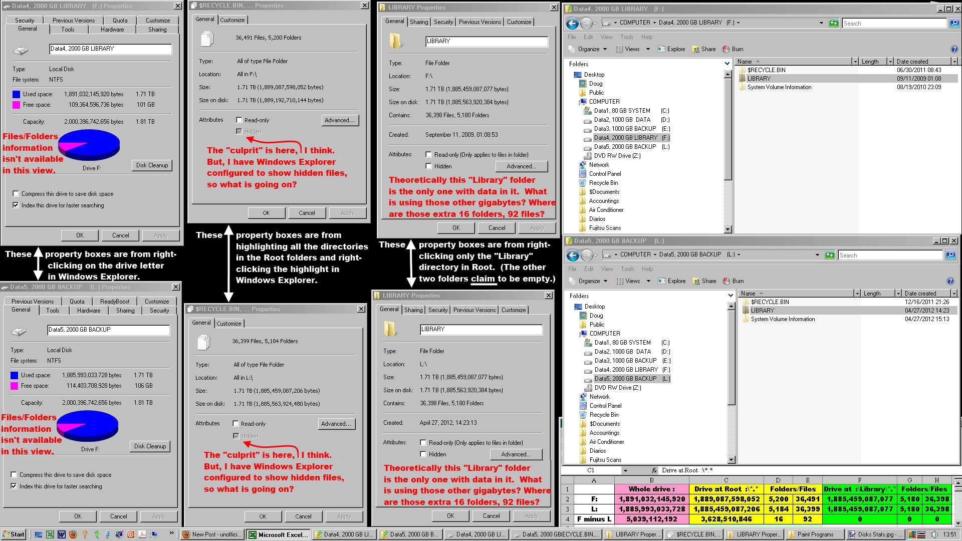

Addendum: The backup finished, and depending on just which disk statistics I look at, it is either perfect or there is as much as 5GB discrepancy somewhere.
Attached is a very elaborate screenshot showing disk information after the backup. It is too big to display automatically with the post, so you'll have to open the attachment yourself. F: drive is on top, L: drive on the bottom. L: is the backup or destination drive. The gray data boxes are from left to right Properties of the whole Drive; Properties of all the folders in Root; and Properties of just the "Library" directory, as shown by Windows Explorer. The right half of the whole screenshot shows (you're way ahead of me here) the actual Explorer windows. In the lower right corner of the screenshot is a brief spreadsheet with all the pertinent data from the gray boxes, arranged in a compact and easier to read format.
According to Windows Explorer, of the three folders in the Root directory, two are empty ($Recycle Bin and System Volume Information) and the Library folder is the only one with data. I find it encouraging that the Library folders (green highlight) in the F: and the L: drives match exactly, both in number of bytes and in number of Folders/Files. This would suggest that the backup was successful.
However, I am puzzled by the discrepancies in overall disk statistics. At the Drive level (pink highlight), there is a difference of over five gigabytes between F: and L:. Some of this could be attributed to differences in fragmentation between the two drives... but not 5GB worth. The drive level stats don't tell how many folders/files there are. Pity...
At the Root level (yellow highlight), where everything in Root is highlighted then right-clicked for Properties, there is a 3.6GB difference between F: and L:. Also, F: shows 16 folders and 92 files more than L:, no doubt accounting for the 3.6GB difference. But what/where are those files? I have Windows Explorer configured to show hidden and system files, and there are none showing for either drive.
I realize I should just close my eyes and be thankful that my backups are done, but these kind of discrepancies upset me.

That was actually the first thing I thought I'd do. A screenshot that was supposed to be in the original post didn't load, I didn't notice it until now.
For whatever reason, my S.M.A.R.T. program won't start up. Maybe it has to be in the startup menu or something, rather than being loaded after the fact?

Active@ said my hard drives were not connected.
WD SMART Test saw all of the drives, but would only display data for my System drive -- 80 GB IDE -- and said SMART data was not available for the other four drives.
PassMark would display SMART info for the system drive, not the others. [UPDATE: for whatever reason, it now works properly.] [UPDATE: No, it doesn't.]

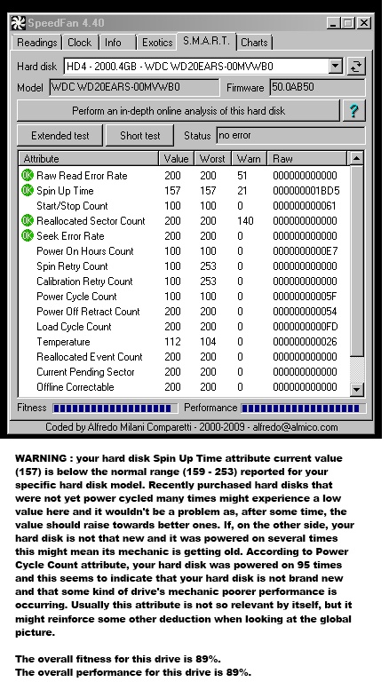

SpeedFan works properly right out of the box. And embarassingly, I have had it installed for more than a year now, and had forgotten I had it.
Below are screenshots of the two monitor programs that worked. What does it all mean?

Oh, and the SMART data you posted looks fine. I got a chuckle out of the software lightly complaining that your drive spins up more quickly than spec.. thats a Good Thing, not a Bad Thing. smile
Unless, perhaps the power supply is over voltage..
