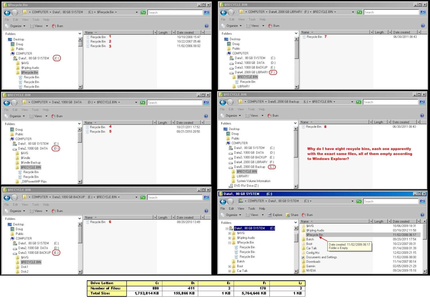

My Windows Explorer shows that while I have one Recycle Bin directory on each hard drive, I have a total of eight Recycle Bins across my five hard drives: 3 on the C: drive, 2 on the D: drive, and one each on E:, F:, and L:. Windows Explorer says each of those five Recycle Bin directories is empty.

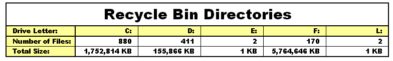

Each of the eight Recycle Bins has the same set of 388 files in it, according to Windows Explorer whatever it is that displays the files when you click on the Recycle Bin icon, and those files are a mish-mash of files deleted across all the drives since the last time I emptied the Recycle Bin. Yet, I have a directory print utility called Agent Ransack that lists all the files in any directory or drive. It shows for each Recycle Bin directory the following:
Gaahh. Rather than try and make some semblance of a table, just look at the first attached picture, below.
Clearly this information bears little relationship to what is displayed by clicking the Recycle Bin icon.

Another question: Why does my C: drive show three separate Recycle Bins?

Inside each X:\$RECYCLE.BIN folder is a set of additional folders, one per user, that are the per-user Recycle Bins. Explorer hides their real names from you, but you can see them from the Command Prompt if you so desire. (They are just the SIDs of the users.) That's why you're seeing multiple Recycle Bins per drive. You can just delete these directly with no ill effects, and you can do that per-drive.
