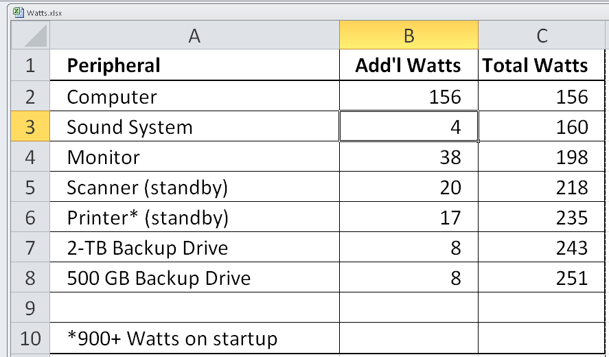

Below is a chart of how much electricity the various components of my computer system use.
Are these reasonable numbers?
Normal mode of operation is at 198 watts.

Time to upgrade to something more modern and power efficient. 156W is way too much.
My MythTV system, with multiple tuners, five hard drives, and a fancy graphics card, doesn't hit that amount even when all of those items are "busy".
Edit: Normal steady state when watching 1080i video is about 85W, and there are far more power-efficient systems available now than when I assembled that one.

Note: I chose to illustrate with the MythTV box because it is the most power-hungry of all of the sytems we have here.
My "daily" workhorse is a 17" notebook (34W in normal use, including the 1920x1200 display panel), and our 24/7 server is now an AMD Fusion board that idles at about 23W with two drives.
Everything else here is also under 50W in normal use.

Wow - I'll need to look at my main system (which does have much lower power usage than the big servers and SGI boxen)
It isn't going to be anywhere near that low :-)
(what did you use to get power figures?)

I measure AC voltage and amperage at the wall socket, and just multiply them together to get watts. I understand that's not a perfect method for AC, but it's more than close enough for practical purposes.
For the MythTV box, I confess I haven't used that method recently. Instead, I'm relying upon the real-time wattage display on the UPS it is plugged into. Kinda fun to watch the displayed values change in response to system activity!
And the figure there includes some external devices (antenna pre-amps) that are also powered from the same UPS.

If I load up all CPU cores on most of these systems, the wattage figures do go up. But that's not the normal 95+% use case. So the figures I've quoted above don't reflect full 200% CPU loads. The MythTV box has a Core2 Duo 2.6GHz CPU, my notebook has a Core2 Duo 2.4GHz CPU, and the AMD Fusion board is an E450 design at 1.65GHz. They all have SpeedStep or Cool'n'Quiet enabled, and so normally are clocked lower than the max GHz ratings. The Core2 systems are now at least two generations out-of-date, and I'd expect newer designs to be more power efficient than those.

Oh, and I did notice a 10-15W reduction on the MythTV system when I recently swapped in a Seasonic 80+-Gold rated supply in place of the Corsair PSU it had been using. The "off" current also dropped to about 2-watts with the new PSU. Excellent results. Now I understand some of the value in expensive PSUs. ![smile smile](/images/graemlins/default_dark/smile.gif)

Time to upgrade to something more modern and power efficient. 156W is way too much. Well.... I could do that, but it would not be cost effective. My house is split out on two meters: one for the computers (mine and SWMBO's) and one for all the rest of the house. The A/C is split evenly between the two meters, with one 110V leg of the 220 the A/C uses coming off of each meter. Right now, after a full year of operation on the split metering, the house has used one kWh more than the computers. My most recent electric bill which covers a two month period, came to 200 pesos for each meter. (This was before the A/C was installed.) That works out to about eight dollars per month for my computers. I should note that in addition to the computers, the second meter also has two telephone systems (one local, one VOIP), a cable modem, and a router. These draw 30 watts 24/7. SWMBO's iMac uses far less power than my system; it is efficient, yes, but also far less powerful than mine. Let's say it uses 1/4 of the power of my system. That means my inefficient power-hungry system is costing me $6.00 per month to run. That's for computer, monitor, scanner, printer, everything. The computer itself is probably costing me about $5.00 per month. So, if I could cut my power usage in half by spending $2,000 to build a really energy-efficient but powerful system, why the electric bill savings would pay for the new computer in just 33 66 years. I'll get right on that. tanstaafl. Edited to correct math error.

Heck no, don't be foolish and buy new. There are lots of punters out there who upgrade to the latest and greatest every 2-3 years, so just grab their cast-offs for 1/10 the new cost. ![smile smile](/images/graemlins/default_dark/smile.gif) The pay-off for your ultra-cheap electric bill may still be in the 2-3 year range, but you'll be doing the planet a favour too, as well as saving some (tiny) hidden costs on the air-conditioning bill as well. Cheers
