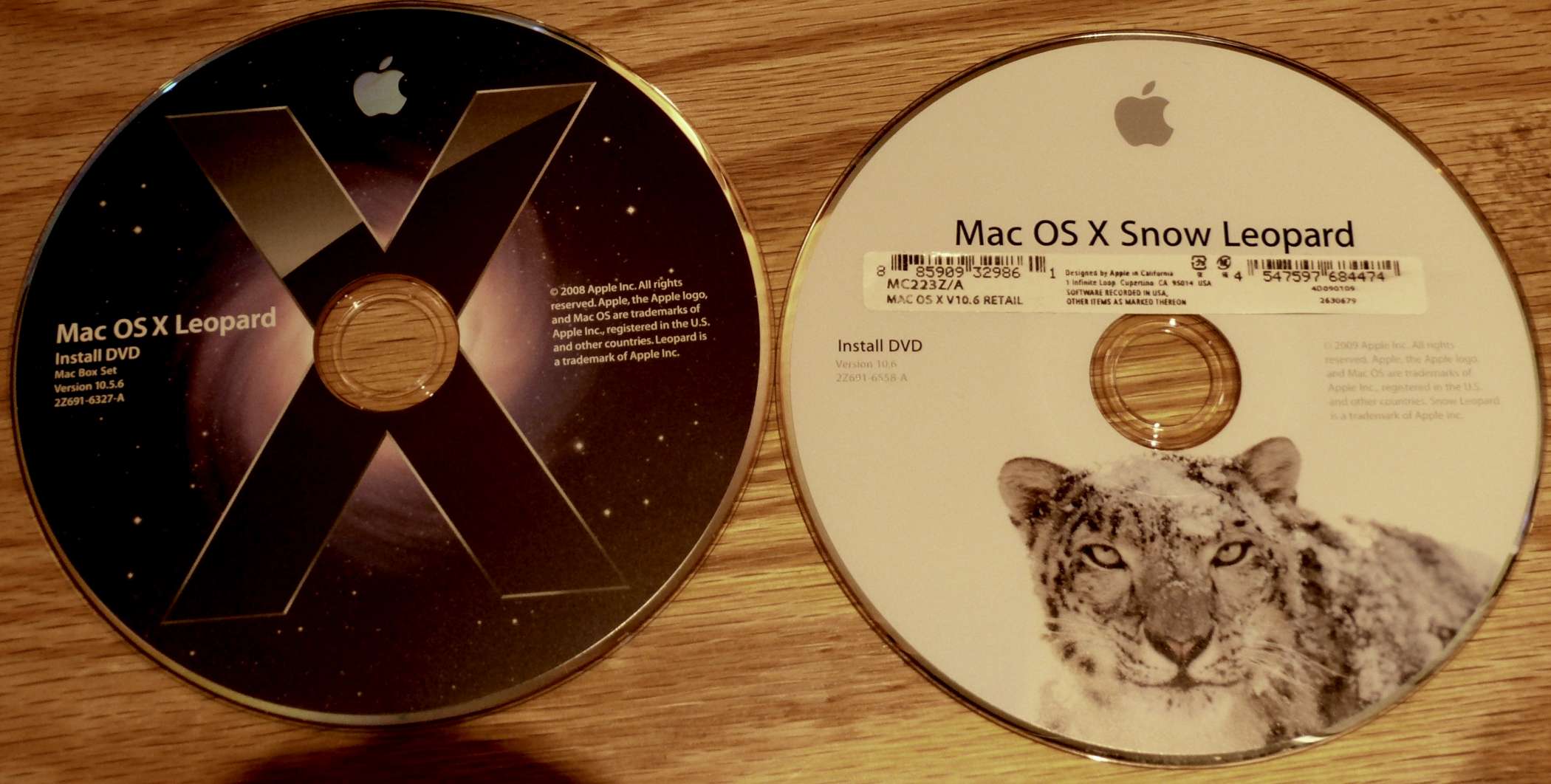

Are the discs grey in color, or do they have a big X (roman numeral 10) on them? They are grey, so they won't be of any real use to me. However... SWMBO says she has a set of 10.6 Snow Leopard disks, still sealed in their cellophane wrappers, somewhere around the house. Unfortunately, her style of storage for things like that will just about require a front end loader to start looking for them. That'll be the project for tomorrow, I guess. The "identify your mac" site you linked to was a bit overwhelming. There must be literally hundreds of different models. I was not successful in identifying my unhappy 20" model (I think I narrowed it down to two possibilities, but am not sure; the serial number identification didn't work for me). Attached is all the information I can glean about the 20" iMac. This is a real screen shot, taken with a camera. None of those wimpy "Print Screen" button pushes for me! (Can you even do something like that on a Mac?) What would you recommend that I do? tanstaafl. edit: The 24" iMac has 6GB of RAM edit 2: Added picture of "Leopards". Does this help matters? Will one or the other of these disks serve to nuke and repave the 20" iMac?
Edited by tanstaafl. (16/12/2012 00:57) Edit Reason: Add Leopards picture

That 20 inch iMac? It's not an Intel machine... That would probably explain a lot of the issues. It's an old IBM PowerPC machine, 2005 at best. And 10.5.8 is the newest OS it will ever run, as 10.6 dropped PowerPC support. Print Screen functions do exist in OS X, but it's not a single key (by default, but can be reassigned). http://osxdaily.com/2010/05/13/print-screen-mac/ shows the various keystrokes, which I'll admit, are arcane and took me a while to remember. FYI, Mark, that system likely included a 4 button rodent. Apple hasn't shipped a single button mouse for 8 years. Apple also has supported multi button mice for OS functions for nearly 13 years, with 3rd party apps making use of them even longer. Perhaps upgrading from Lynx will help show you the more modern web with this news (that is still the default browser on your OS right?

And 10.5.8 is the newest OS it will ever run, as 10.6 dropped PowerPC support. So, then, I can use the 10.5.6 "Leopard" disk to nuke and repave it, right? Insert the disk, power up while holding the "C" key, and follow the directions on-screen. Is that all there is to it, or are there "gotchas" I need to watch out for? Apple hasn't shipped a single button mouse for 8 years. This (attached) is the mouse that came with SWMBO's "new" 24" iMac, which shipped from Apple in 2008. I've only been able to find one button on it. It is clever, though, it is a wireless laser mouse that talks directly to the iMac via Bluetooth. SWMBO has declined its usage, preferring her Logitech 3-button wireless mouse with tilt/scroll wheel. Print Screen functions do exist in OS X, I had to chuckle at that link, clearly written by an Apple fanboy: "Command+Control+Shift+4, then space, then click a window" It's so simple, all you have to do is hold down four keys simultaneously, then hit the space bar and click on your screen, as opposed to the absurd complexity of pressing the "Print Screen" button on a Windows machine. "Once you show someone how to perform the screen capture with a keystroke they understand why there isn’t a need to over complicate the keyboard with unnecessary buttons."Yeah, right. Sometime today or tomorrow I will attempt to nuke and repave the 20" iMac using the Leopard 10.5.6 disk unless I hear differently from you. Would it be worth my while (or even possible?) to update to 10.5.8 after the repaving? tanstaafl.
Insert the disk, power up while holding the "C" key, and follow the directions on-screen. Is that all there is to it, or are there "gotchas" I need to watch out for? The one gotcha is that OS X discs like to preserve user data. For the Leopard Installer, look for an option titled "Erase and Install", on a screen that looks like this That will format the hard drive, then do a completely clean install. Would it be worth my while (or even possible?) to update to 10.5.8 after the repaving? 10.5.8 is a free upgrade that comes from the Software Update menu entry in the Apple menu. With the version scheme of 10.x.y, all .y updates are always free. They are sorta an equivalent to the Windows service packs, just much more frequent. Microsoft deploys hundreds of one issue hot fixes, Apple tends to batch a few up as a .y update every few months. I honestly have to question the usability of the iMac though even after a clean reload. Flash will still perform badly and will not be a new version, as Adobe stopped any PowerPC development ages ago. Most apps on the Mac these days have dropped support for both OS X 10.5 and PowerPC. Looking back at the first post, I doubt it was a junk ware issue. Since it is 10.5, it has a program called Front Row on it, which was more of a TV style media interface. If you buy (or have lying around as it was bundled sometimes) an Apple Remote, you could use the machine for media playback. It should still be able to run a recent enough version of iTunes to receive content shared from your wife's other Mac. The interface looks like this: Without the remote, you can call it up by pressing Cmd-Escape, then using the arrow keys, enter and space to navigate. Print Screen functions do exist in OS X, I had to chuckle at that link, clearly written by an Apple fanboy: "Command+Control+Shift+4, then space, then click a window" It's so simple, all you have to do is hold down four keys simultaneously, then hit the space bar and click on your screen, as opposed to the absurd complexity of pressing the "Print Screen" button on a Windows machine. It is one of my "what were they thinking" moments with OS X. The screen capture commands are really handy, but a four key press chord is weird. In the past I would reassign it to one of the F16-F19 keys, or launch the Grab program. For about the past 3 years (out of my now decade long Mac usage) I finally remember and use the defaults.

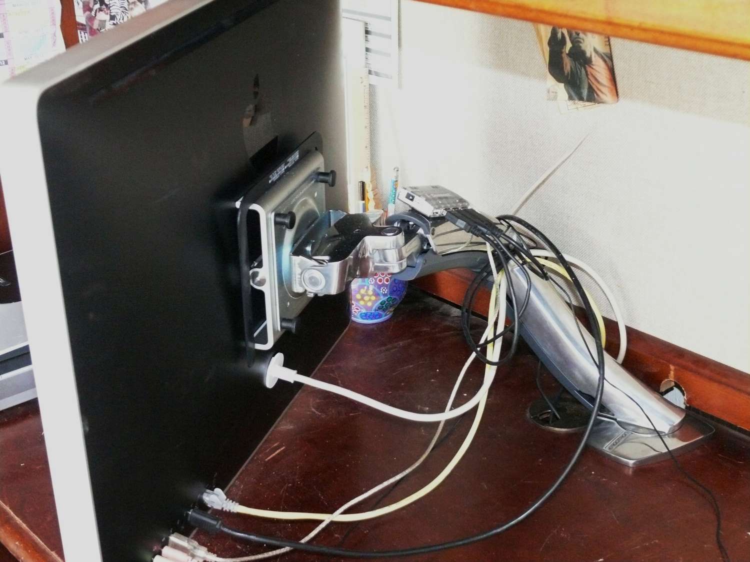

Hey, you've got the same monitor arm I have. (Which might not be a coincidence -- I probably consulted this BBS before buying it.) Are you happy with it? I've got to say I was a bit disappointed with the available vertical adjustment on mine (it wouldn't get an Apple 30in any higher than the factory stand did) and the monitor always seems to be a few degrees off horizontal, which there isn't an adjustment for. I'm thinking of upgrading to a K1D100B... Peter

Hey, you've got the same monitor arm I have. (Which might not be a coincidence -- I probably consulted this BBS before buying it.) Are you happy with it? I've got to say I was a bit disappointed with the available vertical adjustment on mine (it wouldn't get an Apple 30in any higher than the factory stand did) and the monitor always seems to be a few degrees off horizontal, which there isn't an adjustment for. I'm thinking of upgrading to a K1D100B... Peter I bought this arm because it was the only one I could find that would support the weight of a 24" iMac (23+ lbs). It appears to be very well made and is quite heavy. You are correct in that the vertical height adjustment is minimal, but in my particular installation that is a non-issue because it will lift the iMac until it hits the shelf above the work area. With the original stand the iMac wouldn't have fit; I needed the arm to lower the height of the iMac, not raise it! I can lower it until it rests on the desktop, and raise it until it hits the shelf, and still have some working room underneath it, so I can't ask for more than that. I can set the front/back tilt and the horizontal angle to anything I want, and it stays where I put it. Were you looking for some adjustment or setting that would lock it into place? There is none. I wouldn't be able to use the K1D100B you linked to because of the size of the through-the-desk mounting support. This is entirely because of the construction of my particular computer hutch, not any flaw in the K1D100B. I only had to drill a single 5/16" hole through about two inches of pressboard and lock it all down with a 1" by 5" steel plate underneath secured by a simple wing nut. Absolutely ideal for my particular setup. The arm is rock solid as installed. tanstaafl.

I can set the front/back tilt and the horizontal angle to anything I want, and it stays where I put it. Were you looking for some adjustment or setting that would lock it into place? There is none. I'm talking about what might be called the portrait/landscape rotation. On mine (and perhaps it's because I have it at the rear of its front-back range, with the arms in a sideways "<" shape) it's as if the portrait/landscape adjustment can only be made up to a point a few degrees short of being actually landscape. There is a "rotation lock" (it's inside the head, so you only get to set it at assembly time), but that doesn't help, because you can only lock it to a place within a range that, with a heavy 30in monitor on (21lb), does not include perfectly horizontal. Peter

That monitor arm looks a bit like the Ergotron MX arm, as it is known here in Canada. Available in either wall or desk mount, supports up to 30lbs. I use the similar Ergotron LX here (supports up to 20lbs) on my 27" screen. Cheers

it's as if the portrait/landscape adjustment can only be made up to a point a few degrees short of being actually landscape. Ah, I see. Since my hutch is so deep and I have that shelf above, the only way I can move into portrait mode is to pull the arm absolutely straight out, and then tilt the iMac so whatever is at the top during the rotation leans forward, otherwise it hits the shelf. (Total height of the below-shelf workspace is less than the landscape measurement of the iMac.) Given that, in either portrait or landscape mode, it will turn at least 10 degrees past the level point before reaching the stop. I can't test it with the arms folded up like you have yours for the reasons stated above. tanstaafl.

That monitor arm looks a bit like the Ergotron MX arm If you are referring to the arm Peter linked to, it is not. The arm that I have IS the Ergotron MX. I also have the Ergotron LX arm for my computer (the MX arm being for SWMBO's iMac.) tanstaafl.
