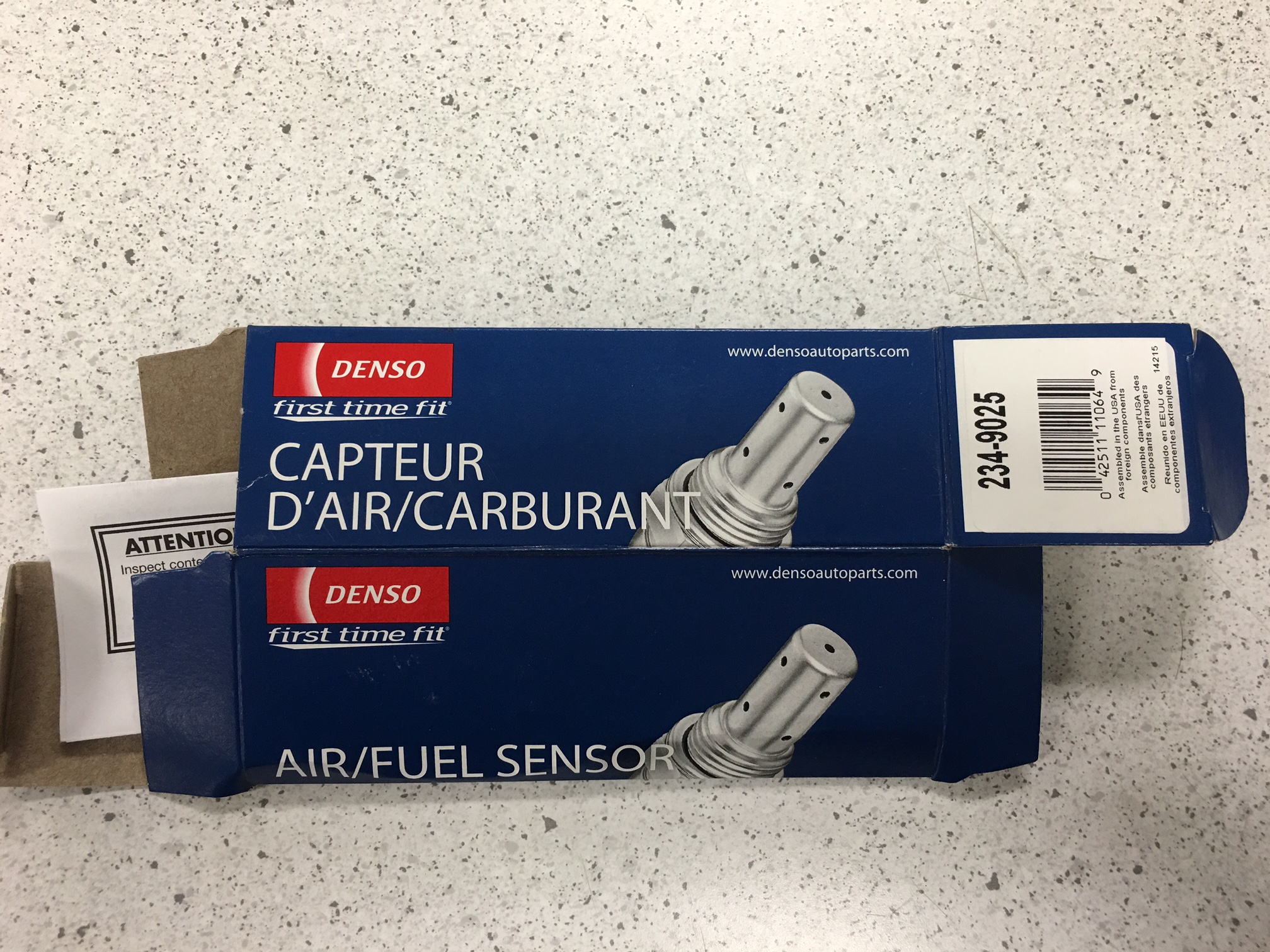

Third time's the charm. When they put the correct part in, the light went off and (so far) stayed off.
Here's the correct part, for posterity:

Good thing it was a "first time fit" part. What's that even supposed to mean?

To be fair, their computer told them all along that the first part was the right part, and they did all the extra leg work to try the other parts after it failed. They were really good about it the whole time, I have no complaints about this shop.
