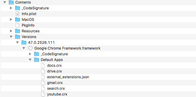

Dug into a few places, and found some of the pieces on top of the abstraction layer buried in a Framework shipped inside Chrome. When using the Chrome browser and visiting some Google sites, users exit the Open Web and start running Google Chrome apps that can have NaCL binaries inside. Similar to how IE could switch over to running some native code on Microsoft sites via ActiveX. Google's done a better job of blending and hiding it then Microsoft did in the 90s. Basically this is a built in equivalent of what browser plugins have been doing too. However with the Chrome hooks into the OS, they can make a URL redirect to a Chrome App instead of the users default browser. Very sneaky.
Once I set the following Chrome flags (
chrome://flags in the URL bar) to these settings, all the hooks the abstraction layer was extending into OS X seems to have been disengaged, and Reminders no longer sees a "YouTube App" inside Chrome to use. It now properly wants to open YouTube in my default browser of Safari.
