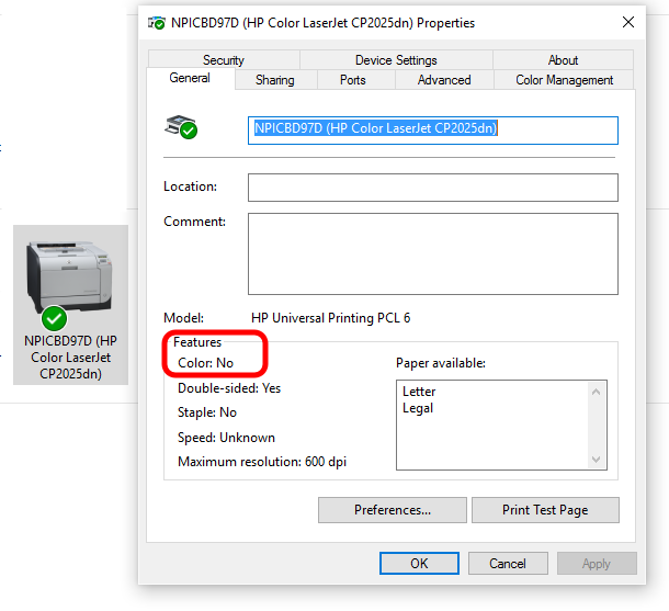

But the printer now insists on printing black and white. I can use the controls on the printer itself to print a test page, and it prints in truly glorious color. But if I dig deep enough in the printer properties in Control Panel --> Devices and Settings --> HP Color Laserjet CP2025dn --> Properties I get what you see in the attachment. I have spent a lot of time looking through all the settings I could find, and can find nothing that allows me to set Color: to Yes instead of No.

I fumbled around with it for a while, gave up and went to bed, and this morning in desperation I deleted all printers from the system and used the "Add Printer" wizard in Windows 10 to reinstall it.
The first time, I told it to use the existing driver, the printer installed and printed black and white only.
I deleted the printer, did the reinstall thing and told it to use a different driver. The printer installed, and now prints in color.
I don't know where the "different" driver came from, I think it is the same PCL-6 driver I have always used. It didn't take long enough for the computer to have downloaded a new driver from somewhere, so does Windows 10 have a reservoir of drivers built in that it installs as needed?
At a guess (reinforced by invincible ignorance) whatever wiped the configuration settings from my router also corrupted the print driver. At least everything is working. For now, anyway...
