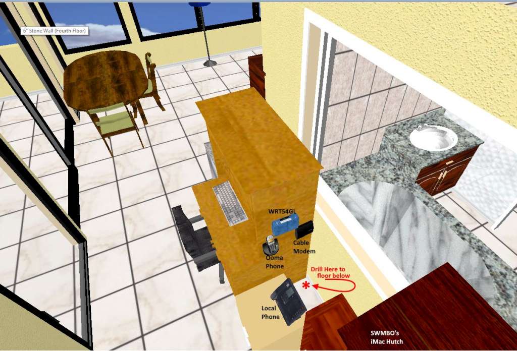

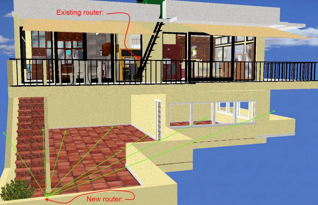

#365891 - 07/02/2016 18:08 Re: Router advice wanted [Re: K447]
Posts: 5383
Without a rather thorough 3D model of the structure
As you can see, there is no easy way to place the primary router so that it could illuminate both residences without stringing cables along the floor and through the air in a most unsightly manner. Should I wish to remain married, this would not be optimal. smile
The first picture shows the current setup with the repeater in place out on the deck of the lower unit.
Mark has made a suggestion that I at first dismissed as impractical, but then after thinking about it, would appear to be a workable solution.
With some effort (I'll have to hire it done, I don't have a hammer drill and an 18" masonry bit) I can drill a 1/2" hole through my floor and into the bedroom ceiling of the room below. I could then run an Ethernet cable down to the second router which would mount on the ceiling. Mark says that instead of being a repeater, the second router would be a simple Access Point, with double the throughput of the current repeater setup. The hole would be quite unobtrusive and SWMBO concurs that it would be OK to "mutilate" the house to that small extent.
One small difficulty will be securing the router to the ceiling. I'll probably end up doing something crude, like pop-rivet aluminum strips to the feet of the router, protruding an inch or so out past the sides, so that when the router is mounted upside down on the ceiling I can run screws through the strips into anchors in the ceiling. Maybe paint the router and the strips to match the ceiling.
Uh-oh! I have to get power to the router as well. Can I run the power cord right along the Ethernet cable without causing interference?
So far this looks like my best solution. I can keep using my G-Class routers and replace them one at a time when they finally quit, configuration is much simpler and straightforward, enough so that even I can manage it, only one wireless network will be required, and overall performance will be better.
#365892 - 07/02/2016 18:46 Re: Router advice wanted [Re: tanstaafl.]
Posts: 13889
Sure, no problem having the power cable alongside the ethernet.
With a half-inch hole, I don't know if the RJ45 plugs will fit through the hole or not -- might need to just feed a raw cable end through the hole, and have somebody crimp a new connector onto it afterward.
One thought, if you're going to do a ceiling mount: shop around for a small, modern router (no more than USD$20) with keyhole slots for screws on the underside. Makes mounting easier, and probably will look better too. The model I would like to recommend (tp link wr720n v1) is no longer sold, but was small, cheap, and very low on power usage.
Configure the downstairs router as a "router", with a separate SSID on a different channel from the upstairs one.
#365893 - 07/02/2016 18:48 Re: Router advice wanted [Re: tanstaafl.]
Posts: 13889
Also note, depending upon where the hole ends up in the ceiling downstairs, you could just run the network cabling to a corner, and then down the wall to floor/desk level there. And put the router and power dongle together on a table or floor there.
One caveat for drilling: apart from steel, what else is embedded in that concrete floor? Any pipes, wires?

#365896 - 07/02/2016 21:49 Re: Router advice wanted [Re: mlord]
Posts: 5383
I measured. 12mm, or .47 inches. Three hundredths of an inch to spare, and if I know Victor (my contractor) his masonry bit will be bent enough that the hole will actually come out closer to 9/16ths then half an inch. smile
Not where we'll be drilling. The steel... just hope we miss it.
#365897 - 07/02/2016 21:50 Re: Router advice wanted [Re: tanstaafl.]
Posts: 679
Loc: Toronto, Ontario, Canada
One small difficulty will be securing the router to the ceiling...
Some routers have keyhole style mounting holes on the underside, which can hold the unit to the ceiling of the holes are carefully located and the screws are just the right size to provide a snug fit, and screwed in until they just barely allow the slots to fit over the screws and slide into position.
If you choose this method, I can provide a tip for getting the drilled hole locations fairly precise without any measuring.
There are purpose made ceiling mounts, this one fits the compact Apple Airport Express router.

#365898 - 07/02/2016 21:55 Re: Router advice wanted [Re: tanstaafl.]
Posts: 679
I suggest making the hole a tad larger, perhaps 3/4" size. Power cord for the router with end attached will need some wiggle room, and the sharp cornered RJ45 plugs tend to snag.
Thread a pull cord (string) through first, then draw one cable at a time through. Make the pull cord long enough that you don't pull the other end through, create a loop in the middle and use that to bring the cord ends down.

In this situation I would suggest using a factory assembled Ethernet cable with both ends in place, from a reputable source. Do not remove the end, make the hole big enough to fit the cable through without damage.
Look for either CAT5e or CAT6 rated cable. I consider CAT5 (without the e suffix) to be deprecated and not worth using as proper CAT5e cable is generally not more expensive.
Among low priced network cables it is not unusual for the ink printing on the cable jacket to over state the actual caliber of the cable product inside. There is almost no enforcement of technical standards regarding bulk manufactured cabling from low cost 'offshore' producers. Not just for Ethernet, of course, as we have seen with USB-C, HDMI, etc.
My own experiences with power line networking is that in almost every case I ended up removing the power line gear. Either it did not work consistently in the necessary locations, or it became troublesome later on. Often the problem causes were unclear ('electrical noise' from 'something' is often the prime suspect) or the power line devices themselves just became flakey.

I think that for the immediate future I will stick with the WRT54GL routers until they quit working, but I will connect the two routers by Ethernet through a hole in the floor/ceiling rather than wireless. Both of them have been working perfectly for the last week or so, so perhaps they will continue.
What configuration changes will be necessary for the second router, which is currently running as a repeater with DD-WRT, receiving a wireless signal from the primary router and then rebroadcasting it?

Crimping an 8-pin UTP connector is generally a fiddly business, especially the first few times.
In this situation I would suggest using a factory assembled Ethernet cable with both ends in place...
Bah, it's not that bad. Sure, it takes a little practice, but it's pretty easy to do once you get the hang of it. Then again, I have the color order burned into my brain at this point, so maybe I forget how tough it was the first few times I did it.
You can just plug in the ethernet cable (through the ceiling) and it will work. Plug it into one of the four LAN ports.
But.. Messy. VERY messy.
Instead, plug the ethernet cable into the WAN ("Internet") port, and then visit the web GUI on the device and set "Type" to "DHCP".
Unfortunately, my personal memory is worsening, and my own WRT54GL devices all have Tomato firmware rather than DD-WRT. But do (by all means!) email me if there is any confusion or issue. We'll sort it out. I can/will install DD-WRT on a spare to make things simpler for both of us!
That will result in a double NAT situation. Why is the straight plug in messy?
Just set it up with a second SSID and run it on the same network. Doesn't need any special settings. Set them up for different channels so they don't interfere with each other. You can possibly even set them to the same SSID etc and almost roam between them (not quite that simple).
Was there a requirement to keep the networks separate at all?
