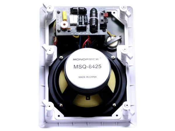

But don't the car speakers need something more than just speaker wire going into them? Every time I've seen a pre-built speaker, there's been some sort of board along with it, like in the attached photo...

In the photo you show, that "board" attached to the speaker is just the crossover for the tweeter/woofer. It's entirely passive electronics and doesn't require a separate power supply. So the speaker pictured only needs the speaker wires going to it.
The only issue you'd have with putting car speakers into a home wall location is that most home speakers are a different ohm impedance than cars speakers. I don't remember which is which, but one is usually 4ohm and one is usually 8ohm impedance if I recall correctly. So if you want to use car speakers in your walls, make sure you know what their impedance is, and whether your home stereo can handle that.
At the very least, putting car speakers in as your rear surround speakers will result in large volume mismatch between your front and rear speakers, possibly a large enough difference that you won't be able to compensate for it in your amp's speaker balance adjustment settings.

I was wondering if that was something to handle the distribution of the audio to each driver. Makes sense that it's a crossover.

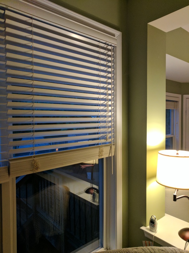

I might not have described this well enough, but the stud doesn't run that way. Cutting 2" would go right through it and well into the drywall face around the corner. I've attached a photo of this weird stubby wall to give a better idea of what I'm talking about. I want to attach the speaker to the left-hand side of that wall. I could put it on the face, but that wouldn't look great and the depth of those studs would probably leave me the same amount of space...

Spaces like that often have multiple studs and very small hollows.
The ones in my house certainly do - I got pics when they were put in...

May I suggest putting a compact 'bookshelf' speaker on the existing shelf where the small white electronic doo-dad thingy is sitting?
You can buy a white speaker, or paint one.
