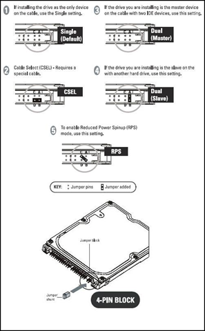

I don't know what the jumpers should be set to on these things, there's no dox.
I googled it, and found this picture:
Thanks so much! I think that explains the issues I was having with getting two drives working. The jumper configurations are not what I expected.
#371933 - 13/05/2019 18:26 Re: Replacement SSD? [Re: Roger]
Posts: 14525
Note that the picture was for a different brand drive, but the master/slave/CSEL setups are pretty much always the same across brands. The only one to avoid is the diagonal RPS jumper, which is probably brand/model specific.
Empegs use the Single/Master and Slave positions from the diagram.

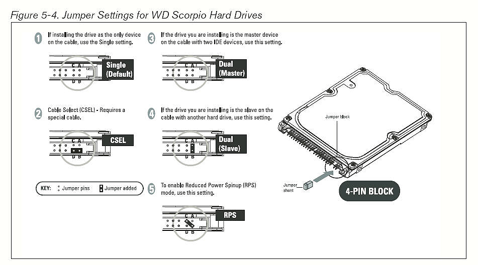

Attached: A slightly higher rez version of the diagram, thanks to "find visually similar images" in google search. At some point we'll work out how I can get read/write access to the new Riocar.org site and I'll add that diagram to the drive upgrade guide.
I don't know how you found that image in the first place, all my search terms produced either photos of disk drives or diagrams for desktop drive jumpers.
EDIT: This diagram may be incorrect for the KingSpec drives with the red KingSpec logo. In order to get the drive to work as master in a dual drive configuration, I had to put jumpers over pins 1/2. Whereas the diagram says that's "slave".
So it's not the same thing for all the drives out there.
