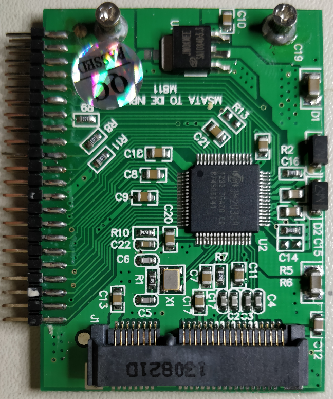

Roger (not me) did get lucky with an mSATA adapter though.

#372230 - 26/08/2019 18:35 Re: Time to refurbish my MK2A. [Re: gmarsh]
Posts: 14414
Originally Posted By: gmarsh
Heavens! I had no recollection of ever trying that! But I guess it did work. Wonder where that adapter is now? The mSATA drive is now in a SATA enclosure in one of the notebook computers here. smile
But in the 5-years since that was posted, CF Cards have gotten a lot bigger, quicker, and cheaper. And based on recent research/experiments by several of us here in 2019, CF-Cards are the recommended solution. The adapters for those are as cheap as US$2 (eBay).
Edited by mlord (26/08/2019 18:56)
#372231 - 26/08/2019 18:42 Re: Time to refurbish my MK2A. [Re: mlord]
Posts: 14414
Found it: JM20330 bridge chip.
So.. perhaps any style SATA adapter with that exact chip might also work, including for full-size SATA SSDs ?
Description: mSATA adapter from 2014.
Description: thumbnail
Edited by mlord (26/08/2019 18:55)
#372233 - 26/08/2019 23:43 Re: Time to refurbish my MK2A. [Re: gmarsh]
gmarsh
Registered: 29/04/2005
Posts: 18
Loc: Halifax, NS, Canada
Cool, thanks for posting that!
The common cheap ones from 10 different manufacturers on Amazon all seem to use the same chip, same signals seem to come out the same sides of the chip and the parts surrounding the chip look roughly the same.
I'll nab one and see what happens.

It's certainly possible that some of Mark's fixes solved the problems with an SSD. Or you have a really good adapter device! smile
#372548 - 16/01/2020 14:07 Re: Time to refurbish my MK2A. [Re: gmarsh]
Posts: 14414
Some of the IDE-SATA adapters out there do work, and others don't. And some of the mSATA-to-IDE adapters also work. Some SD-Card adapters also work, but not many it seems. Sometimes they work only for drives up to 32GB, sometimes for any size drive.
The old Kingspec PATA SSDs work very well, but the newer (since 2014 or so?) PATA SSDs are really native SATA with an IDE/SATA adapter built in, and those do not work.
CompactFlash cards currently have a 100% success rate, as Tony mentioned.

The JM20330 based adapter Mark showed above worked for him, which gave me some hope that the QNINE one I bought off Amazon (which also has a JM20330 on it) would work. The JM20330s have built-in firmware/microcode/whatever, there's no external chip holding firmware that the vendor making the PATA/SATA adapter can fuck up. Snoopstah's success post gives me more hope smile
I've got one of these old things: http://www.vantecusa.com/products_detail.php?p_id=52
Plugging one of the old Empeg drives into it, my desktop sees the drive OK, so PATA side of the adapter is fine. Two SATA drives I have (256gb SSD, 500mb HDD) work with the SATA side of the adapter. But neither of those drives, through the QNINE adapter and plugged into the PATA side of the adapter, work.
I stole a 40<->44 pin PATA adapter from the junk bin at work, I'll try it tonight in my desktop to see if the QNINE springs to life, but I'm pessimistic.
