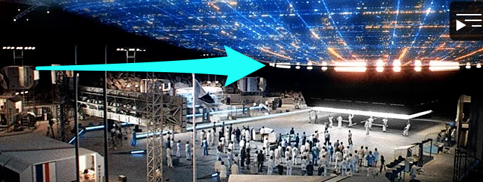

#373969 - 02/01/2023 07:09 Anyone know how Douglas Trumbull did these particular lights?
Google isn't helping on this one so far. But I'm sure it must have been covered at some point in some "Making Of" special sometime. Photo attached, of the lights I'm talking about. The ring of moving lights around the edge of the airlock opening of the CE3K mothership. They moved in unusual flowing patterns which were very interesting. I'm referring to the "idle" animation of the white lights, by the way, not the hand-animated colorful ones from the conversation scene.
My guess is that it was done with a variation of his slit-scan technique that he famously used for the trippy stargate sequence in "2001". It has that kind of feel to it.
It's a shame he died last year, otherwise I could have just emailed and asked him directly. I even spoke to him once at a public appearance in Seattle several years ago, but I didn't think to ask him about it at the time.
Did anyone happen to watch some kind of "Making Of" special which covered this particular thing?
ce3k ring lights.png (1017 downloads)

In this section of the documentary, at about 1:21:30, Dennis Muren talk about a projecting a moire pattern, but I think he's referring to the large dome instead of the ring lights.
https://youtu.be/_XytWm9m9cY?t=4887

I've got a bunch of photos that I took of the original mothership model, from when I visited it at the Smithsonian's Udvar-Hazy Center. (It's a lot of fun to find all the easter eggs on that model.) Alas, that's not the same model that was used to create the projected dome or the ring lights. The dome and ring lights were done with a separate, larger model of just that subsection.

Okay, it appears to be described on pages 231 and 232 of this book:
https://books.google.com/books?id=B-ERra...hip&f=false
Though the Google preview omits page 231, the amount that spills over onto page 232 gives me some tantalizing hints. They call that light ring “the scanner” apparently. I’ll be getting that book soon.

Long term goal is to fully understand the original VFX process so that I can write a proper simulation in code, and run that on my LED light strips.

#374000 - 10/01/2023 23:04 Re: Anyone know how Douglas Trumbull did these particular lights? [Re: tfabris]
Close Encounters of the Third Kind - Scanner Effect
From the book "Close Encounters of the Third Kind - The Making of Steven Spielberg's Classic Film" by Ray Morton
"Another important lighting effect on the underbelly was the scanner- a series of white lights that rotate around the circular cutout from which the hatch emerges. To create the scanner, a piece of fiber-optic cable was attached to a tiny motorized arm that circled around the cutout at the rate of one revolution per frame. The cable was threaded down through the underbelly and attached to a motorized grip that moved back and forth on a track set up in front of a very bright light source. Robert Swarthe cut several zigzag patterns out of pieces of shiny black paper, which were then mounted in glass and placed between the light source and the motorized grip. During filming, the grip would move past the patterns. The black paper would block the light coming from the source, but when the grip moved over an open area in the pattern, the light would shine through and the fiber optic would transmit it to the scanner arm. This on-again, off-again pattern broke the scanner line into segments. The long exposures employed to shoot each frame caused the lights to streak a bit. As a result, some of the scanner lights appeared to expand and contract, while others appeared to merge with and separate from one another. Like the other light patterns, the scanner effect was filmed in its own separate pass."

I can't find any pictures of the actual fiber optic rig, or more importantly, the black zigzag patterns. Robert Swarthe is still alive according to Wikipedia (age 80) but I have no idea how to contact him. Anyone have any ideas of how I might email him or his family?

Currently listening to an interview with Robert Swarthe on a podcast from several years ago ("The Optical", episodes 18 and 19). Also contacting the podcast producer to see if he's still got contact info for him.

Currently in an email exchange with Robert Swarthe. He's very nice and is answering my questions. More details later. smile

Report:
Robert Swarthe was very nice, we had a long Zoom call and we've been exchanging emails. He really went above and beyond for me, creating a graphic and sending me a photo and all sorts of other stuff. Great guy.
Here's the work-in-progress document about the effect:
https://github.com/tfabris/Close-Encount...ner%20Effect.md

Document has been updated quite a bit. Also, the document has been moved to its own code repository and it has a custom short URL now:
https://bit.ly/CE3K-Scanner
I'm in touch with three different people who worked on the effect and I have all the details now. Dennis Muren even scanned some old photos for me. smile
I'm still working on making the Arduino code properly simulate the effect, but now I've got all the info I need and it's just a matter of hacking at the code until it's perfect.
