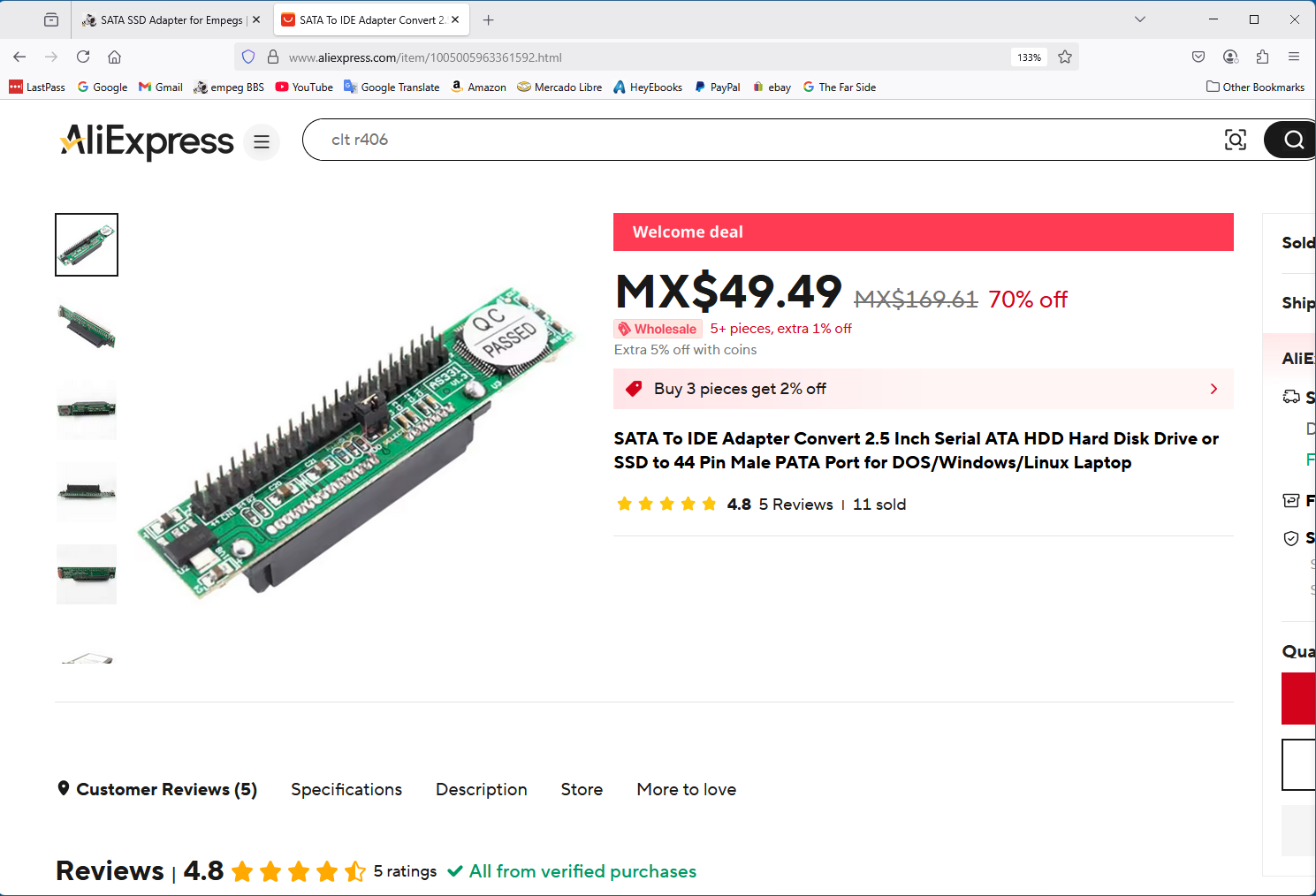

Ever want to use an off-the-shelf SATA SSD with the empeg? Or even TWO of them?
Well, here's a cheap adapter/bridge that has now been tested and proven to work with the empeg:
https://www.aliexpress.com/item/1005005963361592.html
I have tested it with four different SSDs thus far, and everything has worked perfectly without any glitches.
128GB SATA SSDs are under $20 these days on Amazon. Just saying..

The link to Aliexpress doesn't seem to work (or at least, I see a flash of an image but then it redirects to a 404 error). I tried some google-fu, and divined that it might be
https://www.aliexpress.com/i/3256804880520824.html?gatewayAdapt=4itemAdapt#nav-specification
(the "Color: To 2.5 IDE 180 Male" version)
And to my eye, that looks like it's probably this:
https://www.amazon.com/Xiwai-Female-Converter-Adapter-Laptop/dp/B09PL9C44D/ref=sr_1_4
Can anyone confirm that this is likely to work? I powered up my Empeg for the first time in a while a few days ago, and the drive is all clicks and clacks and "Contact support". So I'm looking to maybe replace it ... and I'm cheap. smile
Thanks!
#374612 - 29/05/2025 11:15 Re: SATA SSD Adapter for Empegs [Re: mlord]
The only way to know, is to get one and try it. The Asian manufacturers constantly change the chips on their products without changing the model names/numbers. Back in 2024, we found one specific version that worked then.
?? It works for me.

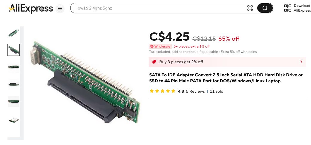

Or for us in the Great White North:
Description: Cheap!
