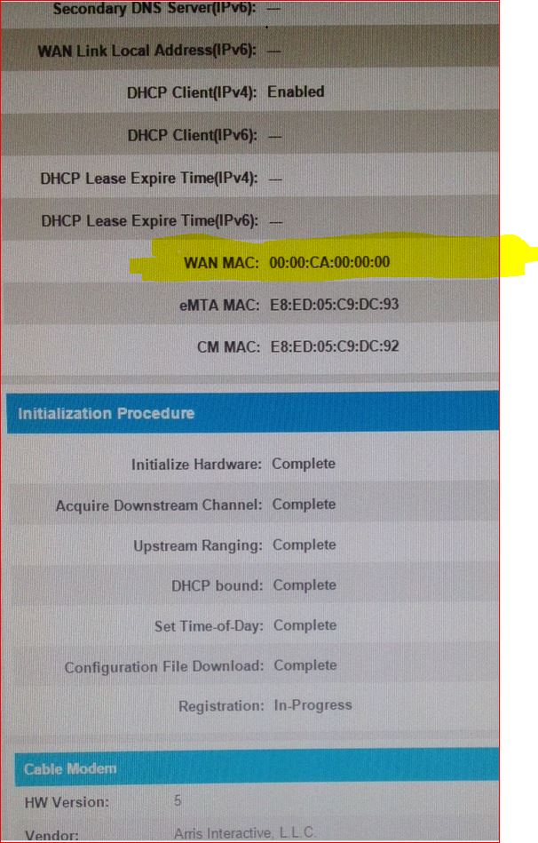

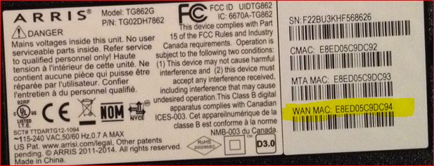

Okay I think I see the bit that got fucked up, the WAN MAC address is borked. It's mostly zeroes when it should be just one digit off from the cmac.
No way to fix it. I'm convinced it was Comcast that altered it.

One digit off? Surely the WAN MAC address is the CMAC?

i've never seen the customer provided equipment mac be called the WAN mac, and it shouldn't cause issues with their system regardless, only yours.
No way to fix it ... What does the manufacturer say about such things?

What does the manufacturer say about such things? I am beginning a dialogue with Arris, and they say that the WAN mac address should be unchangeable, they are as surprised as I was to see that it was different. We'll see if they are able to escalate this into something that can get me some resolution here beyond "buy yet another new modem and keep doing it as long as this problem keeps resurfacing".

I saw a page about using an SNMP tool to access the Arris modem in "Technician" mode, but it said that it no longer worked with the updated firmware. That's the thing: I think these modems do have backdoors into which the technicians can poke, but pretty much only Comcast knows them at this point.

Known bug in the Arris firmware. The issue is that there's something wrong with the DHCP negotiation in the final stage of registration. The problem is permanent, and can't be fixed without just replacing the modem.
By "known bug", I mean, it was a bug that's been occurring for years now and only recently (last 6 months) did the comcast techs finally understand it to be an actual bug that made them keep having to replace Arris modems. Supposedly, according to my tech, Arris has acknowledged this bug. Now, since Comcast supplies the firmware, I don't see why they can't fix the bug and push out a new firmware rev, but I don't understand how this stuff works on the back end.
