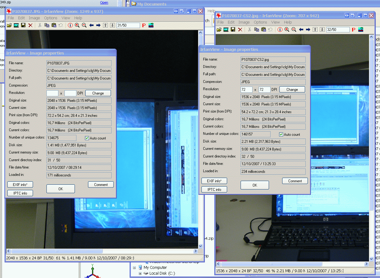

#304935 - 10/12/2007 14:32 Re: Syncing photos to ipod- Is there a better way? [Re: Ezekiel]
Posts: 31622
Tony,
It's so strange though. I copied a CD of my parent's trip to italy over to the touch as a test, and every photo worked fine.
Then they all must have gotten pixel-rotated by a piece of software before they went on that CD.
"My impression is that iTunes doesnt bother to read exif data at all. "
How can that be correct? Exif is the only place a jpeg can store that data.
As Tom said, it assumes another piece of software got its mitts on the file first, and did the actual pixel-rotation, and therefore it does not need to interpret any exif rotational data.
Send me two pictures (one processed & one unprocessed).
Okay. Taking the photo now... I'll send you the unprocessed portrait photo. Hopefully the BBS will accept a 1.4 megabyte file...
The file is unaltered from the camera. I simply took the file directly off the memory card and zipped it up. It has never been opened in any application.
portrait.zip (106 downloads)
#304936 - 10/12/2007 14:35 Re: Syncing photos to ipod- Is there a better way? [Re: tfabris]
Posts: 31622
By the way, with that attached photo:
- When I open it with the default Windows Vista application for opening JPG files ("Windows Photo Gallery"), it is sideways, because that application also doesn't auto-rotate the thing based on exif data.
- When I open it in IRFanView or Paint Shop Pro, it comes up portrait, because those applications *DO* auto-rotate based on exif data.
#304937 - 10/12/2007 14:43 Re: Syncing photos to ipod- Is there a better way? [Re: tfabris]
Posts: 31622
And if you look at the Exif data, the file does say PORTRAIT- RIGHT TOP which is the correct tag. It would say something else if I'd held the camera the other way round.

I did the following:
Opened original file with Irfanview 3.98.
Chose 'Image:Information'
Opened original in Photoshop CS2 (opened correctly in portrait mode). Saved as <>_cs2.jpg.
Opened this copy in Irfanview.
My results:
Original file - opened with computer monitor sideways in Irfan 3.98.
Edited file - opened with computer monitor rightways round in Irfan 3.98.
File information in Irfan 3.98-
shows the original at 2048x1536.
shows the edited copy at 1536x2048.
(as does CS2)
Exif data in both files was identical (See attached tab-delimited .txt file).
That leaves this question: what tag does CS2 use to tell orientation that Irfanview 3.98 and iTunes ignore?
-Zeke
EDIT: I got Irfanview 4.1 and had the same orientation results as 3.98 (opened original in landscape, re-saved copy in portrait)
tony_file_comparo.txt (357 downloads)

This is the EXIF data of the original file:
File Type = JPEG
File Size = 1477951
