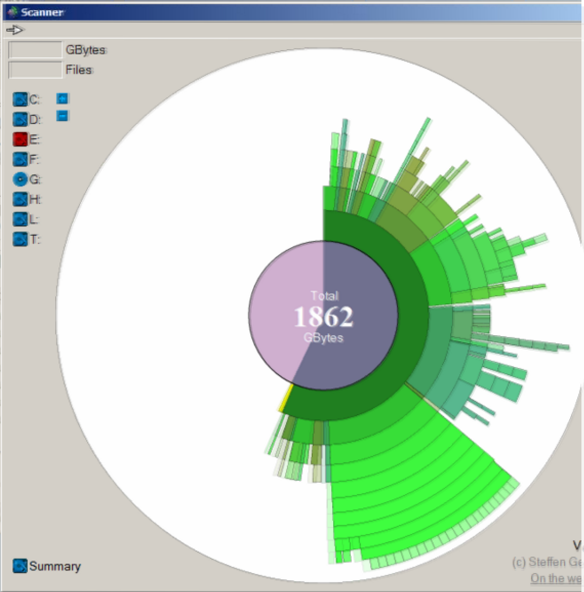

2) I'm a little puzzled about the storage I'm left with. The new volume appears to have 1.04TB of data on it. This is on Sunday, when the upgrade finished last night. There's no way it could have had that much data on it on Thursday. And I just looked again and it appears to be growing. Any thoughts on a good way to figure out where the data is being added?
#371578 - 20/01/2019 21:14 Re: Server drive migration [Re: Dignan]
Ok, I found an answer to question #2, and I'm pretty proud of the incredibly scientific way I solved it.
Using my favorite disk utilization visualization tool, Scanner (I believe it was Bitt Faulk's recommendation ages ago), I took a couple screenshots of the drive about 20 minutes apart. I then pasted them into Paint.net into different layers, changed the opacity on the second layer so I could overlap them as close as possible, and looked for differences. I should have guessed that the perpetrator was the largest user folder on the drive. Now I just need to figure out what they've got going on that's sucking up all this space! Users, amirite?
Edited by Dignan (20/01/2019 21:14)

The program above does the exact same thing, but I like the visualization the best of the applications out there. I think I used to use Treesize but moved to Scanner because it works so well. I love the graphical representation as a pie chart. I can then click on any of the blocks and that block becomes the gray circle in the middle with the files/subfolders filling the pie chart around it.
But neither of these programs could really do what I was looking for, which was tell me what was changing. I knew that gigs of data was being added every so often, I just didn't know where. The above solution was the most elegant I could come up with.
