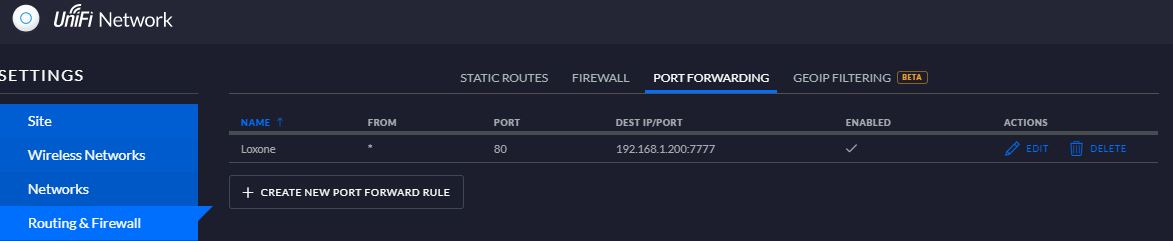

Just got one problem though. I can't seem to access my Loxone home automation from outside the LAN anymore. With the old router I had set "port forwarding" up like below, and that has always worked fine. (first image)
With Unifi, I set it up like in the second image, but it doesn't work. It looks the same to me? Anybody got any ideas?
edit : those screenshots look pretty small, but I can't seem to make them bigger. I hope you can read them (you can if you zoom in on your screen).

#371916 - 11/05/2019 21:52 Re: Ubiquiti Unifi setup - running very hot? [Re: BartDG]
Do you have your source and destination ports reversed?
#371917 - 11/05/2019 22:03 Re: Ubiquiti Unifi setup - running very hot? [Re: jmwking]
I tried that, but that didn't work. The ip address in the unifi controller also said "192.168.1.200:80" then too, so I figured that couldn't be right.
#371918 - 11/05/2019 22:55 Re: Ubiquiti Unifi setup - running very hot? [Re: BartDG]
It certainly looks like you have the ports back to front, unless one of the UIs is badly labelled.
#371919 - 11/05/2019 23:00 Re: Ubiquiti Unifi setup - running very hot? [Re: andy]
You're right. They were back to front. But then it still did't work.
Then I tried setting it to port 80 in the setup menu of the Loxone server, and then it worked.  But I don't want to use that port for security reasons.  So I then reset the port back to 7777 and guess what? It kept working!!
Very strange, but I guess I'll  just be happy it works and not worry about it.
Thanks for the help!

The first time you tried it you did give the controller enough time to provision the USG? Changes in the unifi world are not realtime, you have to wait until the controller decides to provision the changes on the device you've modified and then wait enough time for that device to update and reload it's new configuration. Normally this doesn't take very long, but as I said, it's not a realtime change.

That is one of the few things about Unifi that annoys me, there are far too many config changes that require the access points to "reprovision" (which basically involves the AP rebooting), that really don't seem like they should need it.
It does probably make testing easier for their dev team though.
Mind you, the cheap managed hubs I've used also need to reboot to change pretty much any setting (the difference being they reboot in a few seconds).

Yes, I did wait until the provisioning was done and the unit back to "online" status. But it didn't make any difference, not until I changed the port setting into the Loxone server. (after which the Loxone server also rebooted, so maybe that was the reason it ended up working)
