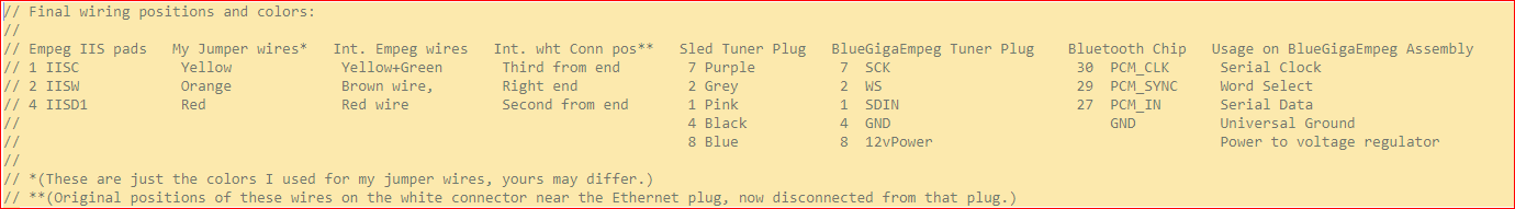

Also, a reminder about my final wiring scheme for the I2S pins and how they relate to the tuner connector. I carefully disconnect three wires from the white connector inside of the empeg that is closest to the ethernet port on the empeg motherboard, and then solder them via jumpers to the IIS header as described in my source code, screenshot below.
Click to embiggen:
